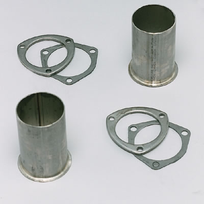

I spent the day making the cutout fixtures and mocking them to the exhaust in several places. Found the max ground clearance was 5 inches in front of the x-pipe and 4" just after the x-pipe. I decided to mount them after the x-pipe facing down. This will probably compromise the efficiency of them but I'm sure it will be neligible. I wanted to hear the x-pipe through the cutouts as it seems to really smooth out the exhaust.

It has to do with the axis of the butterfly valve and the high angle of the cutouts themselves. Mounted before the x-pipe the butterfly axis is parallel to the pipe and the butterfly has its edge to the flow of the pipe. Mounted after the x-pipe the axis is perpendicular to the pipe and when open the butterfly is face-on to the flow. The butterfly actually sticks up into the pipe a wee bit and may try to divert more of the flow out the front of the valve instead of equally before and behind the valve.
Before the x-pipe, parallel axis:
After the x-pipe, perpendicular axis:
Also, the effect of the 90 deg angle of the cutouts is minimized before the x-pipe since its very close to an outside turn in the pipe. After the x-pipe the pipes are pretty straight and I wonder how much flow will really be diverted out the cutouts. Most cutouts have a low exit angle of approx. 30 deg and will divert much of the flow when open. I have not been able to find any material on the effects of a 90 deg exit angle but I spoke with some of the propulsion and aero engineers in my office and they agreed it will flow less. How much less..who knows. Could be insignificant. Bottom line, I'll eat the slight loss in hp to hear the engine through the x-pipe.
Typical cutout and the ones I purchased but could not use:
I made mine from header reducers, I cut them and notched them to fit the 3" pipes:
PS: No comments about the crappy welds.
