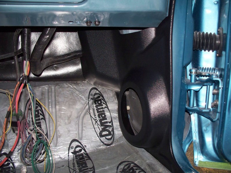

A couple of pieces came in today. UPS delivered kick panels with cutouts for speakers. I going to use Infinity speakers. The headunit will be a RetroSound Model 1.

JL Kick panel speaker.
Since I installed a deep speaker, I have to cut some bracing, I bolted a strap on to make up for what I cut out. It would have been better to weld this on, but I'm going to risk weld splatter burning something. I should have test fitted this much earlier in the project.
