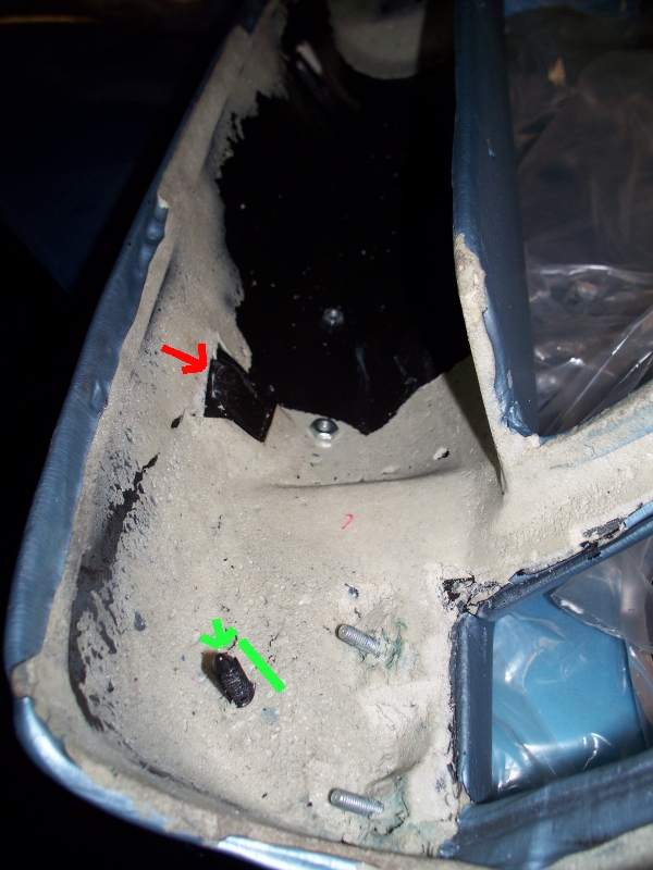

The repro dash is the one on the roof. The problem is that it does not stay attached very well and comes loose too easy. There are really two problems. Both can be solved, however I lost interest in making further modifications and the ability to do them when I injured my elbow.
Problem one - Green arrow, the plastic retainer is too short. There are probably several ways you could lengthen the retainer.
Problem two - Red arrow, the plastic does not hold the metal clips very well. This could be solved by bonding some metal backing to the dash pad.

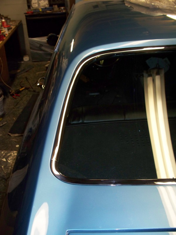

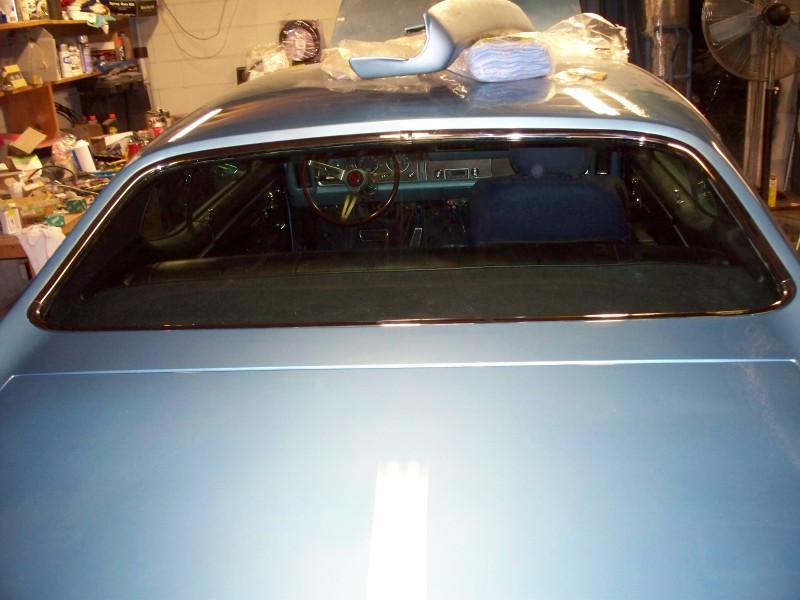

Installed the rear window trim. The trim restoration was not bad considering the poor shape of the trim. There were 80 grit scratches on part of it and it was badly dented. I took about two hours taping the dents out and another 6 hours removing all of the scratches. I had to sand part of the trim with 400 grit, then 600, 1000 and 2000 before I could even buff it. With the buffing compounds I had on hand, 2000 grit scratches were hard to remove.

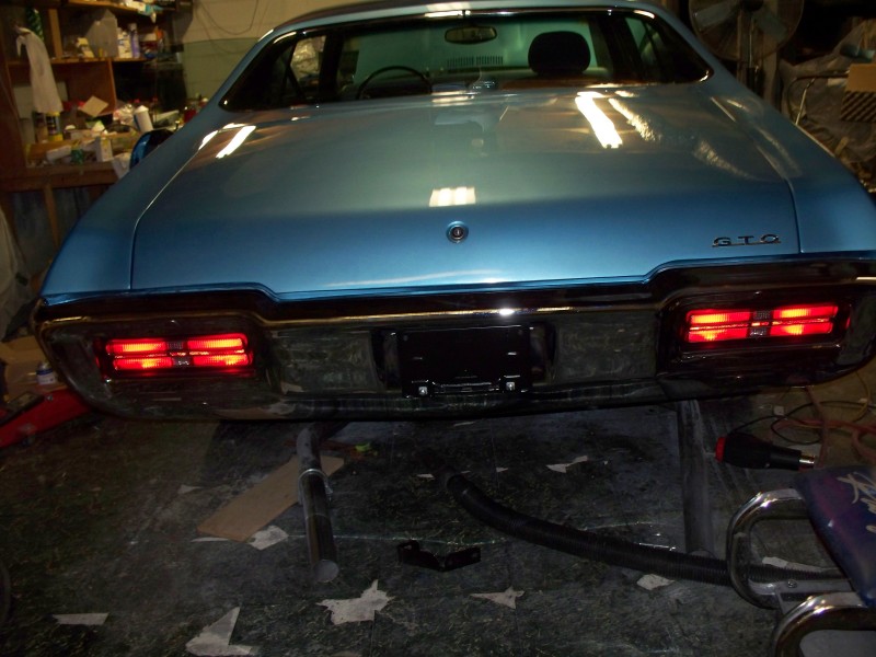

I resolved the tail light problem. The wires for brake and turn were reversed in the right hand tail light assembly. Rather than remove the bumper I just swapped the wires in the rear light harness connector. I'm not even sure if it's even feasible to swap the wires at the light socket.

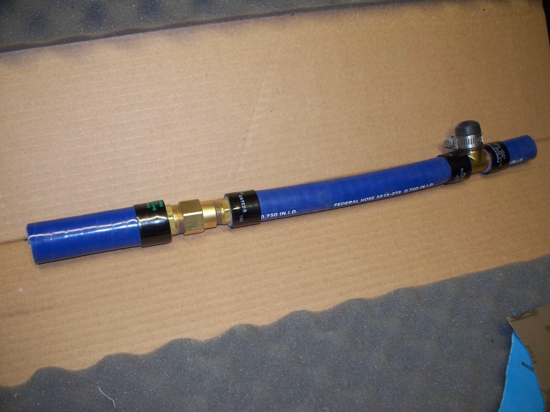

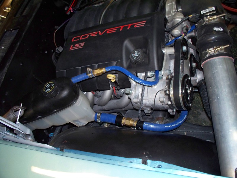

Made a hose to go from the engine to the coolant tank. Really I just added the Tee (capped right now) Will connect to the Vintage Air unit eventually.
Hose installed, also had to cut the engine cover around the AC compressor.

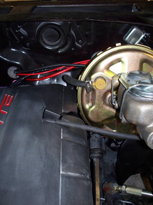

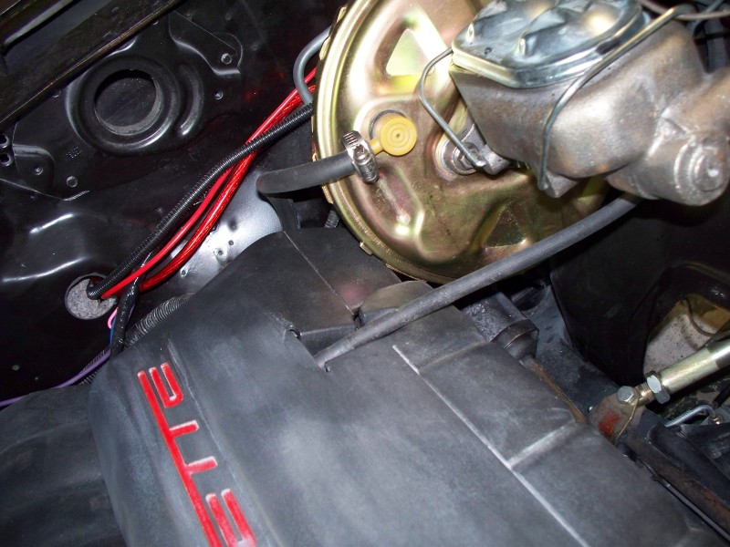

The driver side engine cover hits the brake booster.
Trimmed slightly to clear

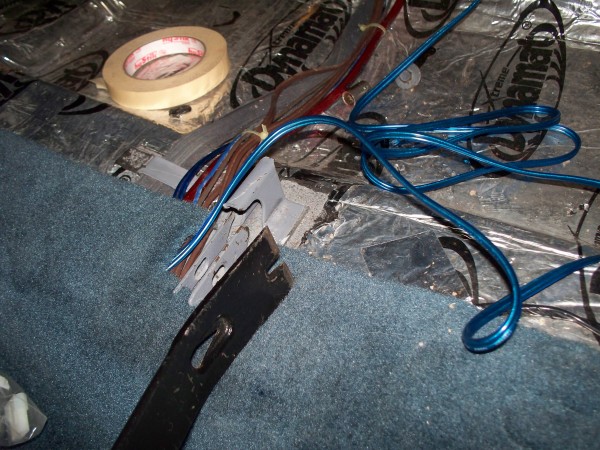

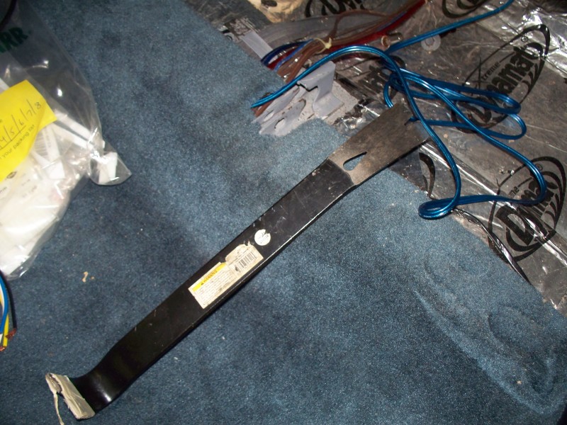

Tip of the Day. To remove the rear seat, use a pry bar. The notch will engage the wire and you can press and lift with one simple motion. I was able to remove the rear seat using only my left hand.
You will need to tilt the bar slightly to catch the seat wire.
