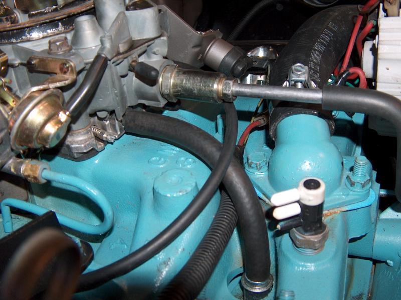

I am still having trouble with this car of mine. I tried to drive it to a cruise-in about an hour from here on March 7th, and got about half way, and the car quit on me. We had just set the timing at 8 deg. BTDC. The temp. gauge was still registering high. The car actually shut off, after starting to skip a little. I looked under the hood, didn't see any violent behavior of any kind, and actually hit the starter, and the car turned over, fired a little, but I didn't start it immediately. I let it sit for about 45 min., then tried to drive it back home, but it was still skipping and acting weak. A friend of mine came to pick me and the car up, and he said by listening to the engine that I might have some sort of ignition or carburetor problem, but it didn't sound like the engine was messed up. Just for information purposes, the car has a DUI distributor on it, so I don't know if this is contributing to my problem or not. There are also a few ports plugged on the intake and carb., and I don't know what the effect of these might be. My next move will probably be to take the water pump off to check the rubber seal, maybe put the stock distributor back on, then if that doesn't work, I guess I'll take it to Classic Pontiac Rescue on Donalds, S.C. Maybe they are more familiar with these engines, and can help me out, I don't know. I am getting quite frustrated, as you folks might guess, because I have in my shop what is fast approaching a 20k boat anchor, that I can not drive. I am backing off the car for a while, to try to re-group.
Name:	Canam fittings 001.jpg
ID:	161885   Click image for larger version
Name:	Canam fittings 002.jpg

The tree valve that is disconnected is listed as it controls the EGR and EFE thermal vacuum. Is the EGR disconnected? It would help if someone posted the emission control system vacuum diagram for the 77 400 to see how it should be connected.
Also you should get a bottom battery spacer and the battery hold down parts that are still available.
