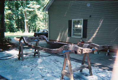

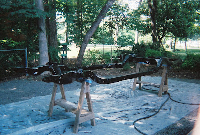

Once I had the body pulled from the frame, I was ready to get going and get something done. I was extremely motivated at the beginning of the project. I've since learned that you need to treat this like eating an elephant, one bite at a time. I started out by removing the rear suspension. Man were the bushings shot. The control arms were pretty rusty. They are probably still use-able if anyone wants to pay a couples bucks for them. I chose not to re-use them as you will see in a few posts.
After the rear suspension was out, I proceeded to pull the front. This is where I learned the importance of a spring compressor. In hind sight it wasn't that big of a deal, but I scared the crap out of myself when I let the first castle nut on the ball joint loose.
I pulled the rest of the junk off of the frame and sandblasted it using the Black Diamond Media you can get from Tractor Supply. I used a home made sandblaster out of an aviation flight line fire bottle (sorry no pics). After blasting the frame and wiping it down to get rid of as much of the residue as possible, I shot it with an HVLP gun with Eastwood's Extreme Chassis Black Primer and Topcoat. I really like how it turned out and so far its held up pretty good with all the knocking around I've done on it.
