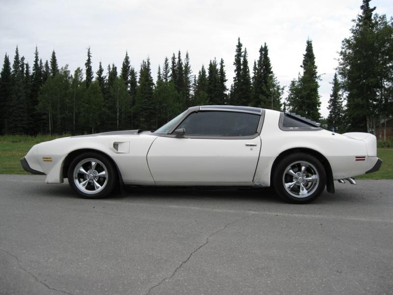

Default 1980 Trans Am 428 E-Head
This is Mine runs great around town ,idles just just right and rumpy, cruises smooth as glass.
Accelerates Like the hand of GOD is pushing you ....smooth as a Nuclear Train !!!
Stops great on factory Dics,,,handles Awesome with spring and shock up-grades.
As a daily driver I'm very pleased :-)....passing is fun !!!
2200 Rpm in OD 200r4 from BTO with 27 tall tires and 3.73 gears....nice smooth powerful ....Quiet also :-)
12 MPG miles around town and 16 MPG on hwy if Im Lucky :-)
No dyno or track time yet .....Next Year
