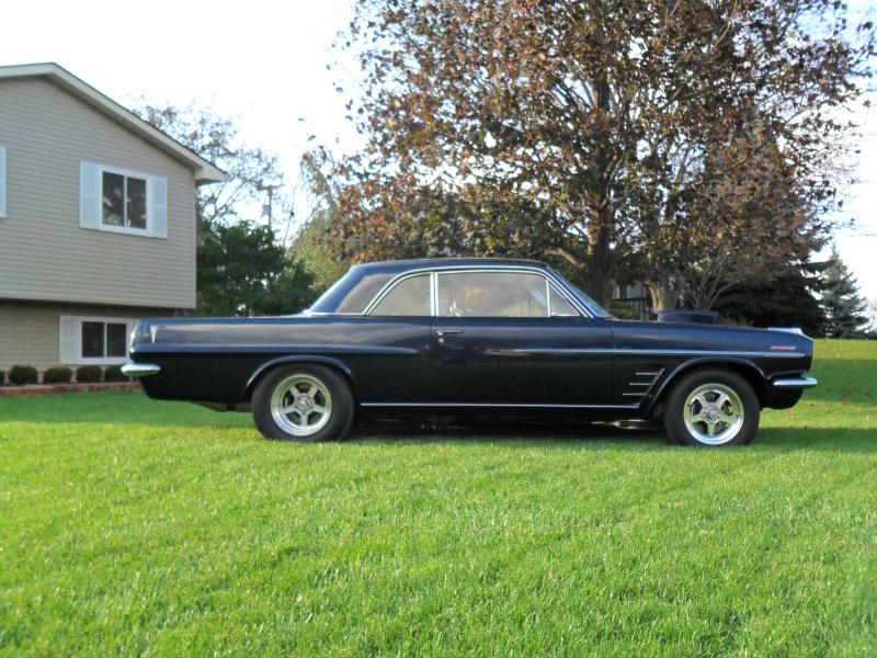

Here is mine. 15x10 rims w/10.5x28x15 Mickeys. Mike
