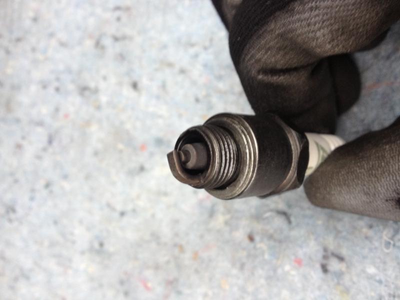

Ok, sooo... Here's a question that I hope someone can answer.
I pulled the plugs today to have a look at them. Number 5, 7, and, 8 are almost bone white. The rest are a medium to dark brown.
Here's a couple pics of 5 and 7. Number 8 is very similar.

They look fine to me. You're splitting hairs here...it's dinosaur technology you're working with. I think you're doing great!

Here's a couple pics of number 1 and 2. Numbers 3, 4, and 6 look the same.
Sorry for the crappy cell phone pictures.
I hope so... I think I'm getting close. It really is amazing how close the Rochester people got these carbs without the use of O2 sensors and computers. There were REALLY close! Especially on the idle transfer area. The idle transfer on this carb is probably the most efficient spot. It consistently reads in the 14.7 range.
