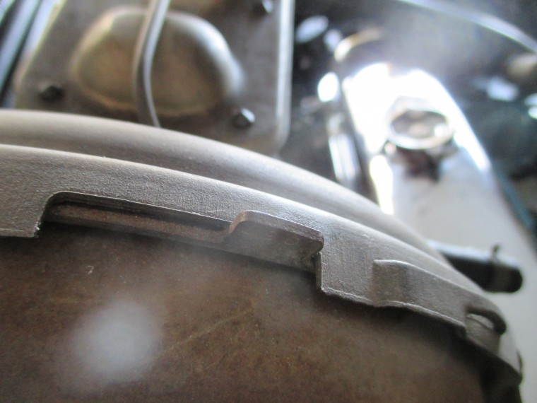

once again am I not looking in the right spot?...I cannot find any numbers...is this the spot??...the fluid cover was a GM replacement from 1990..I would not be surprised if mine needs to be rebuilt as it may be leaking where the master connects to the booster..does that sound right??...thank youClick image for larger version

look on the tab sticking straight up at the 12 o clock position. there will be numbers on the front and rear of the tab. the rear is the model specific code and the front number is the build date. These tabs are part of the rear half of the booster. you showed a picture of this very tab in the 1st photo you included in your post. it is right there..

Default 1972 T/A BOOSTER
Name:	BRAKE BOOSTER  FRONT TAB.jpg
ID:	353752...the front tab part # is 1315...and the rear tab appears to be part # 1957....if someone can explain the meanings it would be appreciated...thank you

the part number is #1957 (this is correct for both 1971 per Bill and Steve Gregorio). the number on the front indicates the Julian date (315th day of the year).
