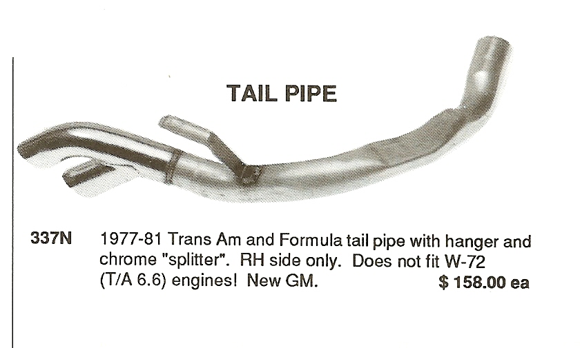

From the “picture is worth 1,000 words” methodology: I scanned these Year 1 & Service Manual images for your use and information.
Note the tailpipe is for “Non-W72” as IIRC the TA also came with a “two-inlet two-outlet” single cross-flow transverse mounted muffler…so the Tail Pipe image below muffler connection is the incorrect bend for the W72 dual exhaust.*
It is included here for reference as to how the hanger (I previously called tab) and splitters were mfg’d and sold by GM & Pontiac.
For ease of use in the garage - Larger Full Size image links below:
- Tail Pipe HERE
- Fig. 6F-13 & Fig 6F-14 Converter & Exhaust Connections HERE
- Fig. 6F-16 Dual Exhaust System F Series HERE
*Refer to Fig. 6F-16 Dual Exhaust for the W72 Tail Pipes.

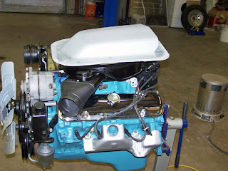

The “traffic signal” ported vacuum switch is referred to as the “EFE & EGR TVV” aka “TVV valve” in the “Street Tuning The Trans AM” information I had previously posted. There have been GM part #s and photos posted on PY in the past. At this time I do not have that information available. Perhaps Rocky Rotella, 2Many, etc. can provide that information?
Also a detail note: I noticed your gas cap appears to be an aftermarket part. No intention to nit-pick, wanted to provide you what the OEM style looks like. See #9864N in the illustration below for the correct gas cap.
Look closely here and you can see the "Bright Blue" TVV on this engine - back side of alternator - behind T-Stat housing:
Larger image of same photo link: http://2.bp.blogspot.com/-cKQ2b0_1i6...W72+engine.jpg
Blog hosting images above http://phscollectorcarworld.blogspot...codes-and.html
EDIT: Here's another large view of a TVV http://www.wallpaperup.com/uploads/w...d75274b76c.jpg
