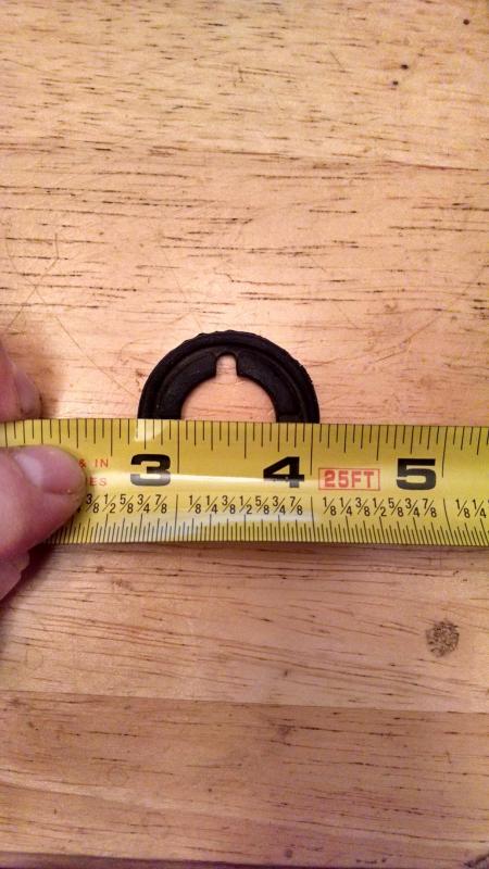

Measuring the gasket opening, it would appear the hole is 3/4 of an inch.

That makes sense to me, I just think the hole in my fender was enlarged wider. its slightly egg shaped, & the widest points are where the two points circled on the base would catch the underside of the fender.
Attachment 383417
That helps a bunch, Thanks for measuring that! Unfortunately it confirms my fear tho. I have 3/4" top to bottom, but 1" side to side were the base should catch. I guess I'll just have to order the parts & see what I need to modify to make it work. Always something with this project.........
