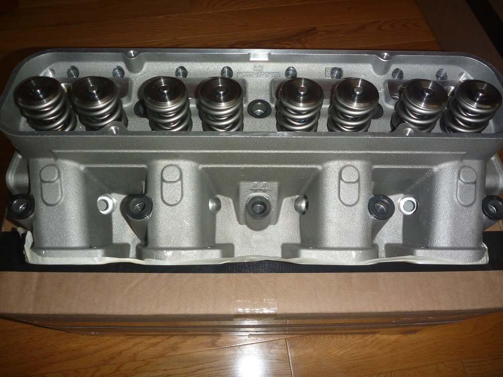

DCI Motorsports RA-V heads are in transit to NH, can't wait to get my hands on them

Default DCI Motorsports RA-V Heads Arrived
As expected Don, you've created a top quality piece for us die hard Pontiac lovers Can't wait to try them out.

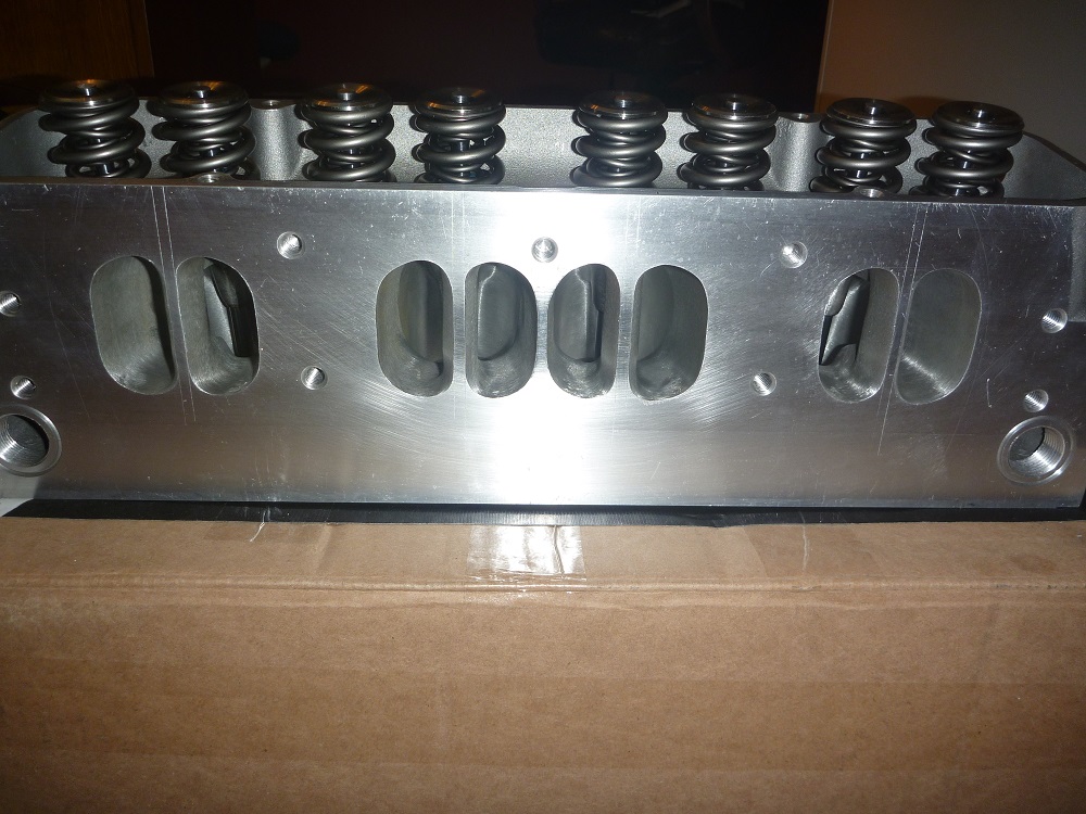

Default DCI RA-V Intake Ports

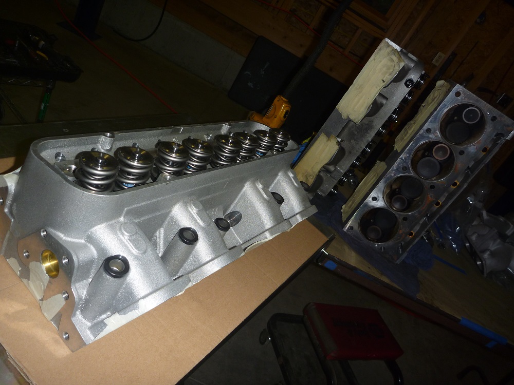

Out with the old McCarty/BES/Indy Cartel RA-V top end, in with the new DCI RA-V top end.

I'm assuming the inlet ports on these heads are unfinished? Surely the divider wall down the centre of each port should be radiused and smoothed off to prevent the airflow from the intake manifold slamming into the square edge? I'm assuming (again) that the intake manifold port exits are round,not split like the head ports?
Maybe it's a 2 stage port like the ole Corvette English engine head.
