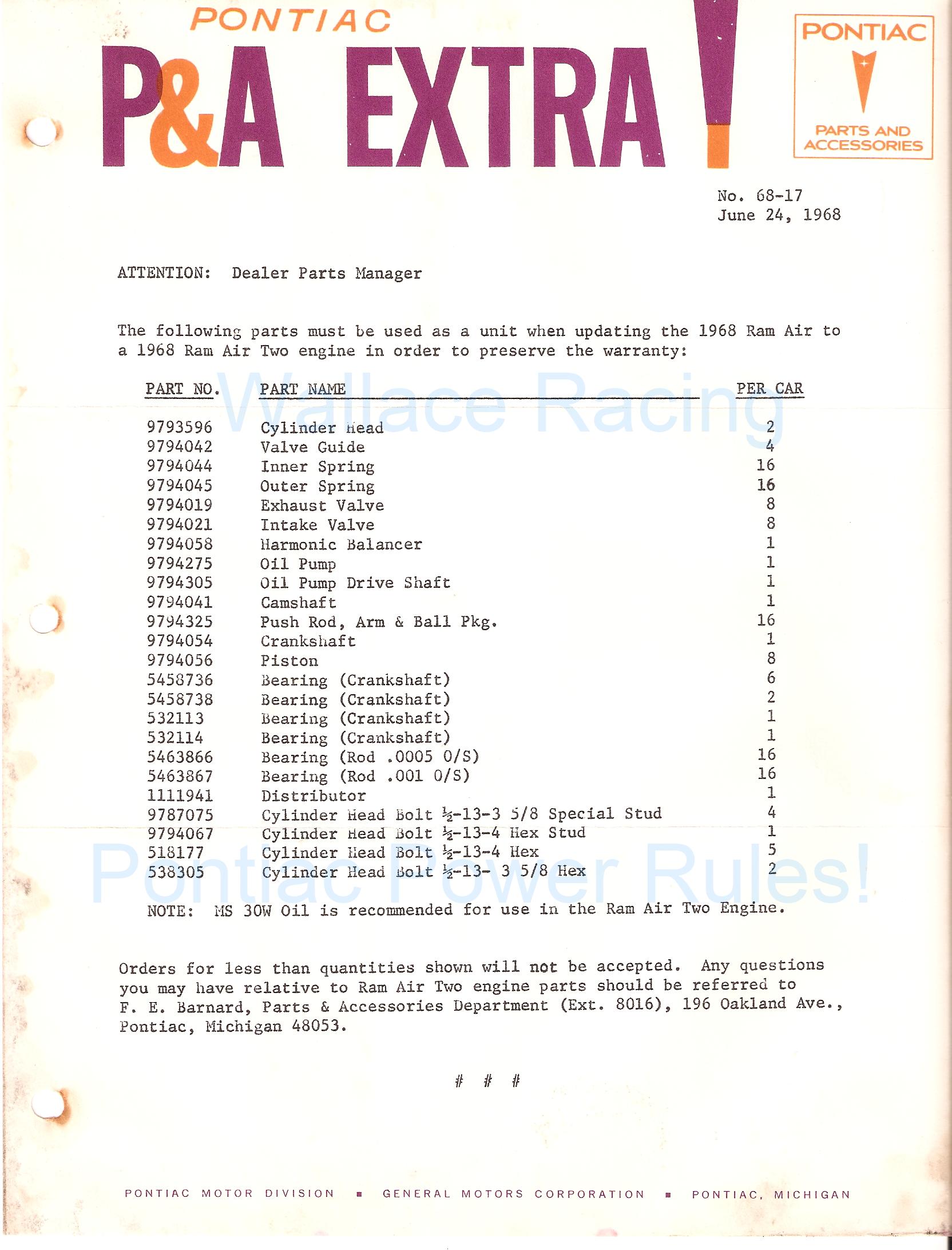

Apparantly Ram Air II's equipped with automatic transmission may have been delivered from the factory with the 068 cam. The 4-speed cars got the 041. I have a letter from Malcom McKellar (Chief Engineer at Pontiac who designed these cams) concerning the RA II stating, "In regard to the camshaft the auto trans was released with the 068 cam". This can be confirmed in Pontiac's parts book which lists the 9779068 camshaft for all 67-68 F/T Ram Air engines with H.T. (Hydramatic transmission) and the 9794041 camshaft for 68 F/T Ram Air with M.T. (manual trans) and WU or WY engines.
However, pre-production sales information and a memo from Pontiac's Parts & Accessories Dept. dated June 24, 1968 that lists the parts that must be ordered to update a 1968 Ram Air to Ram Air II shows only the 9794041 camshaft. This may have been the original intention for NHRA racing purposes but idle requirements on production engines required using the 068 with automatic trans.

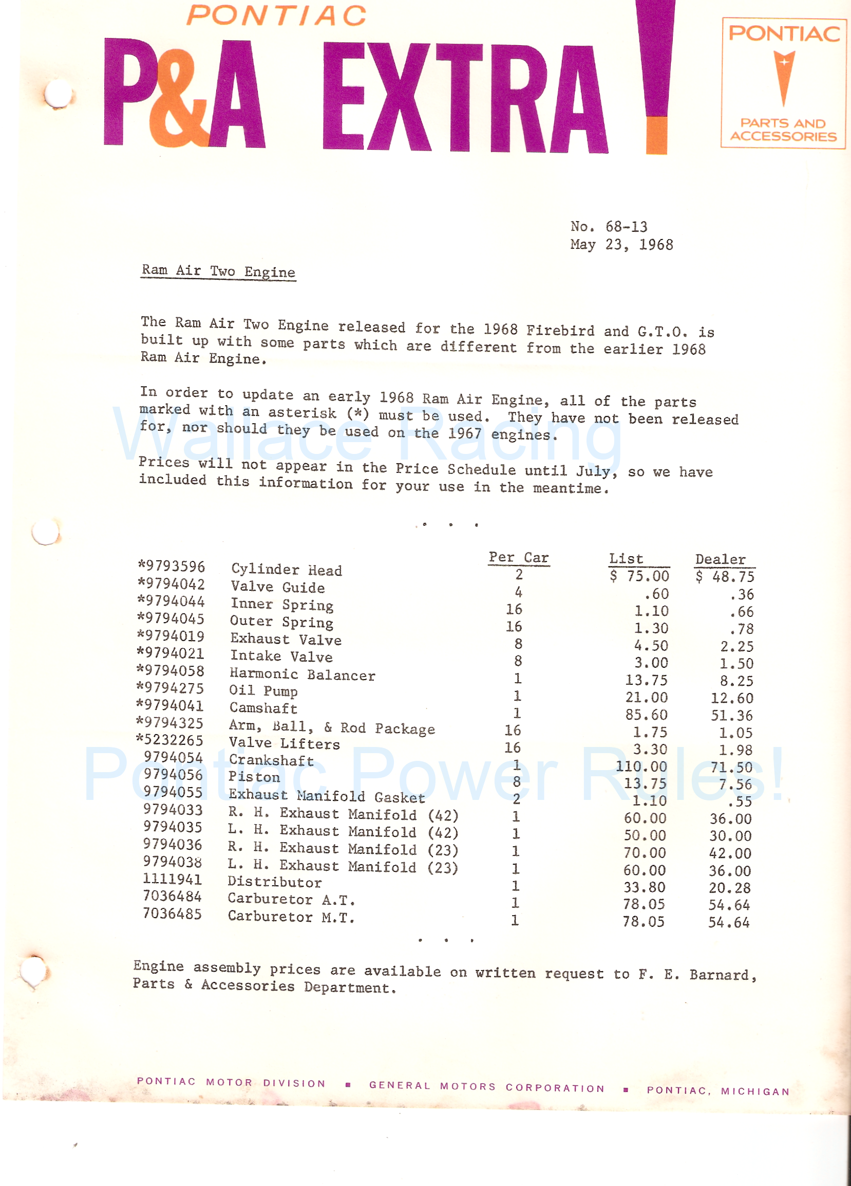

Old thread I know, but I came across this today. Well, a print out of what I had found on the web 5 or 6 years ago when I bought a set of Ram Air II Service Replacement heads.
What I do find interesting is that it lists two different numbered sets of exhaust manifolds.

is there a readable version of that hosted somewhere?

Old 06-30-2016, 06:56 PM
Posts: 22,514
I think I posted these before, but here are links:
This is the May 23, 1968 P&A:
This is the June 24, 1968 P&A
Thanks for posting!

Old 07-04-2016, 09:08 AM
Long branch for the Firebird and the fat GTO style manifolds
