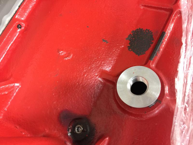

Doing a little work on the coupe this weekend.
just finished up the headers got the block drilled and tapped for the oil return on the external lash adjuster regulator Found this neat little aluminum freeze plug that has a 1/2 not hole in it for my temp gauge and got started on the vacuum takeoff for the Webber intake so I can run a pcv valve
