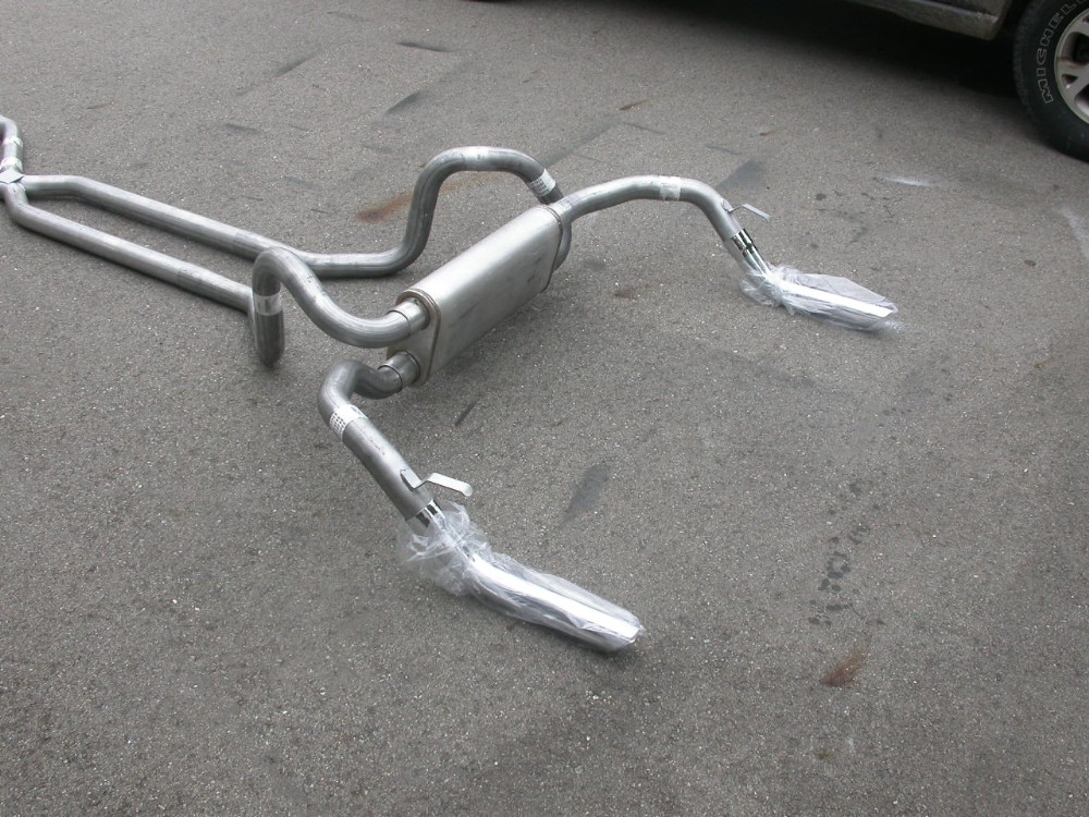

You're correct. I would be surprised. You currently make the welded bracket. I had to remove part of the supplied tailpipe and weld on these short adapters:
Yes, you are currently one of the few with a viable splitter solution. With that said, it could be better. You and some others are satisifed with what's there. From a business case, you don't believe it doesn't make sense for you to engineer one.

My car spent 15 days in the corner of an exhaust shop because they just didn't want to work on it with the Pypes 'kit'. Half of it ended up custom work of theirs, cutting and shutting and rebending, and to make the splitters come out in the original dents and at a suitable angle, even with larger bore. It will need extra tweaking when on the road in several years, and probably quieter mufflers, but it was a major ordeal compared to some that seem to just throw it on in their driveway in a few hours. I thought a ready-made and proven kit would save a lot of money over getting someone here to fabricate the lot from scratch, even with overseas shipping it may have cost-wise but not the hassle.
