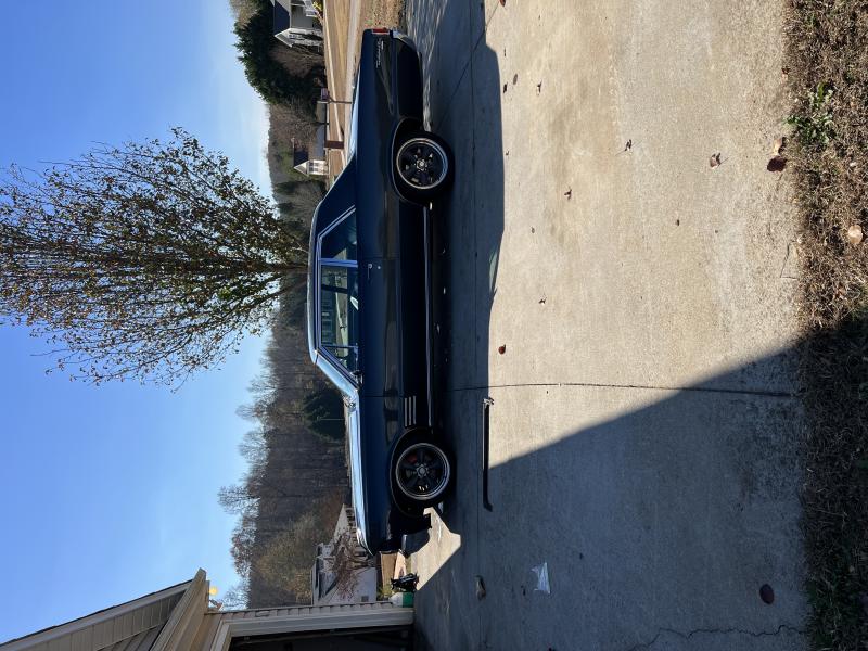

Yep you can see the front wheel again

It's gotta be the wrong bar then, too narrow or something, ride height shouldn't change at all by putting a sway bar on.
Where did you get the sway bar?
In theory the bar shouldn't add any wheel rate or ride height when the vehicle is not in motion. However, because each side of the car will weigh slightly different, especially taking cross-weight into account, one side will always be twisting against the other side.
While I do think that 3/4" of rise from the sway bar is excessive...and may yet point to an issue, it's not unheard of to have a sway bar raise a static ride height by a bit.

Having ran dirt track cars for many years and running large front sway bars on them you can get a ride height gain if the sway bar links are different lengths. To pre load the sway bar on an oval track car I used a 1 1/4 inch longer link on the right front than on the left front, and yes, the RF would gain ride height after the links were connected, just confirming the links are the same length may be the OPs cause of this gain in ride height.
On an oval track car the preload is used to make the bar more responsive by putting twist in it at a stationary stance.
This I understand, but an 1.5" longer link is blatantly noticeable. And intentional.
The Hotchkis bar doesn't have links that slide on the bar end do they?

Does your bar have adjustable end links?

It is the Hotchkiss swaybar that was on the car when I got it.

I will take it to the suspension shop to have them look at it Monday but as of right now it seems fine

Does it turn in evenly in both directions? If turn in is much more abrupt and much sharper in one direction you probably have a lot of cross weight in the car which may be contributing here.
If it drives pretty neutral, has near equal turn in to each direction and isn't doing anything that makes you uncomfortable, I'd probably let sleeping dogs lie.
