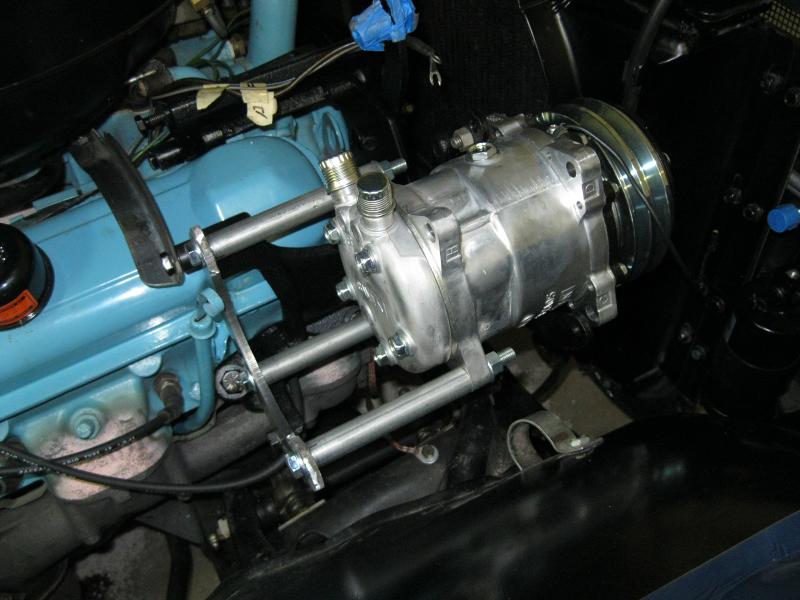

My upper condenser brackets I made from strap metal as the upper provided for a 64 GTO just didn't work out right. I also improvised a bracket for the drier (not shown). That put the condenser inlet and outlet where I wanted them.
I found a 61/62 mount for the A6 compressor and fit it together on a mock up using spate head and manifold. I had to redrill the compressor mounting holes in the front adjusting plate and had to have a rear mounting plate made that I could use with the Sanden compressor.
