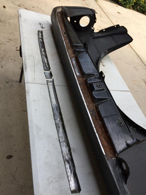

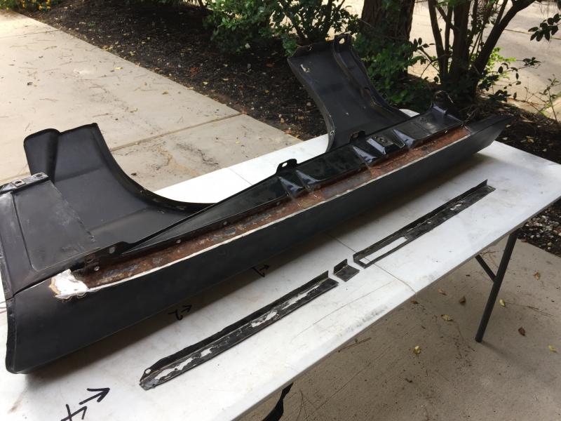

ID:	541086Thanks for the additional feedback. I went ahead and broke out the spot weld remover and cutting disc. Pics of the results included herein. Using the cut outs as templates, I'll try my hand at forming up some replacement piecess from sheet metal. The 90 degree bend should be easy enough. But getting the slight curve in the ninty'd piece is something I need to research. And I can spot weld sheet metal ok. So maybe this is doable? I'll give it a go for sure. Thanks again for the feedback and any suggestions on how to bend up the sheet metal would be appreciated.

That’s a lot of welding ..on that seam. And grinding and fitting to the hood gap. Prayers sent

Its do-able, but very tedious
and probably best to at least try it yourself - with shop costs in mind on top of what you probably already paid the other guy for his "work".
Before getting into all that forming and fitting -
maybe try finding a donor fender to take that section from.
66 and 67 are probably also eligible since they use the same hood.
Most fenders don't get rotted like that in that area.
So very possible someone has a fender that is wrecked or beyond use in other areas that would still be nice in your needed section.
thinking out loud
Thats not really the way i would have went at it, initially.
doesn't make me right or you wrong though

Make the curved section in 2 pieces. Use the wider section as your template to cut a strip of sheet metal the contour needed. The cut a thinner strip to match, and weld it on, tacking it all along the edge spacing out your tacks to minimize heat/warpage. Let cool, then fill in with additional tacks, again well spaced so as not to warp, let cool. Just do not be in a rush and use patience. Then grind to finish.
Don't know how long you plan to keep the car or are looking to flip it, but I might consider as an alternative sandblasting the rusty metal to get it clean, and then use a layer of fiberglass matting to fill it in. Fill with a quality fiberglass "bondo" like Everglass with the fiberglass strands, and sand/smooth, prime, light coat of body putty, sand/smooth, coat of primer, and then ready for paint. More on body work technique than welding and no one will be the wiser.
