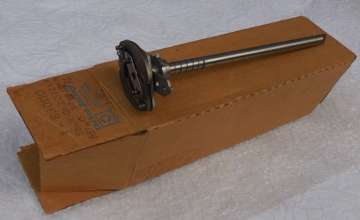

Default 3, 2, 1, Ignition - Houston, we have a problem
I know you wouldn't know it, (because I haven't told you) but for 2+ months I've been wrestling with my HEI trying to dial it in. I finally gave up and sent it to a professional (heretofore known as "The Distributor Guy") who has a Distributor Testing machine, the proper know-how to figure out why my advance isn't fully coming in and an S TON more patience than me.
This post will be one of those "what not to do" type posts. You'll see why.
You know what is apparently being added to the latest list of unobtanium? Genuine GM HEI advance weights. Maybe I'm late to the party and they've been off the market for years, but I'll tell ya, there are none on this forum, and none in any of the 20 GM groups I'm in on Facebook. Pretty astounding considering the amount that were made available from the factory and the amount of people these social sites reach.
Don't get me wrong, the journey has been interesting - got a chance to talk to Rocky Rotella on weight and curves. (If you don't know the name, you're probably fuel injected. ) Man, what a nice guy!! But still no weights.
Got a few folks that said they could help - even willing to go with 139 weights - but I must have ticked them off or something, because they ghosted me in short order. I guess I have a way of doing that.
Enough about that. Lets get to the reason you're all here. My awesome photography.
My big cap HEI is really just a distributor of spark - the 6al does all of the heavy lifting; the dizzy just tells it where to go. No modules lefts to fry, it was strictly the magnetic pickup and the advance mechanism. Simple. Years ago my Distributor Guy even made an advance bushing to limit the curve and dialed it in perfectly, even with the crappy curve kit I had in it.
But if you read any dizzy threads at all, they all have one thing in common - the aftermarket weights and cams are junk. Its true more so today than ever before. Most serious curve guys buy for the springs and throw the rest away.
Whats wrong with my distributor? I don't really know to be honest. All I know is it limits me to half the advance Id expect to see regardless if I use new weights, or the old proven good ones. Yup, all greased, spins freely, shimmed identically as before and doesn't feel odd in any way. Oh, and it ate a bronze gear in 90 minutes of run time.....
....and put a ton of carbon under the rotor in the same timeframe. Yup, I said 90 minutes.
Something ain't right Scoob. Maybe the shaft bent when I dropped that roller lifter waaaay back at the front of this thread? Remember, that oil pump got pretty hot.
So given there are apparently no genuine GM weights left in the world, and my dizzy has gone off to the great carousel of spark in the sky, what options exist before one goes completely fuel injected?
Another Dizzy or a Crank Trigger.

Location: PA
Posts: 4,022
Per my parts manuals, GM, at least back in the '70's did not sell weights and springs separately. They sold the entire shaft assembly as a service part. Here is an example for a Chevy HEI:
Makes sense selling it as a unit from their perspective I suppose. They made sure the ignition curve was right on the assembly line and out it went. Optimizing the curve was up to the hot rodder to make happen. It does beg the question of how one got the right curve back if the distributor ended up being replaced at some point though, doesn't it?
I'm just bummed that with the approximate 7M Pontiacs produced between 74 and 83, most all HEI equipped, (the heyday of HEI?) I thought cams and weights would have been easier to come by. Kind of a ridiculous expectation I suppose considering that was 37 years ago and no one really hoarded the GM stuff until the computers started taking over and the curve kits went to pot.

My HEI is a tad misshapen.
(picture courtesy of Distributor Guy)
This means another housing needs to be sent to said Distributor Guy ASAP. Not sure what happened, but it happened well before I got my hands on it. Its been like that since '97 and has been through 3 major engine iterations. Im sure its fine, but with other housings now standing by, its probably prudent to replace.
Of the 3 available, I'm going with this '77 unit out of a YU coded 400. (Thanks Wallace Racing Distributor page!) Its the oldest of the bunch but its housing is in better shape and its the quickest to ready for paint. (I can't deal with the silver. Great for a resto, but not for me.)
Also sending these parts along, just in case my shaft is bent. They cleaned up nice with a brass wire brush.
This is better!
It'll all be happily on its way on Monday along with some center cams.
