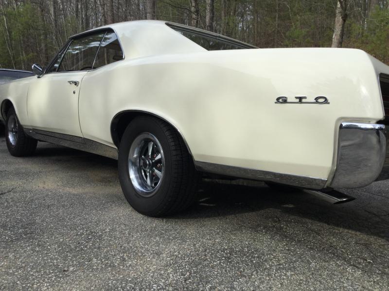

Threw mine inside....I like the look much bettah. Raised white letters just look cheesy to me now.

Attachment 546437
LOL..... I tried that in the spring...... Just had them turned back to RWL...... just missed it too much....
I am determined to get them white
