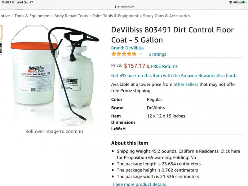

Old 10-27-2021, 11:50 PM
MUSLCAH MUSLCAH is offline
Join Date: Sep 2015
Location: N.H.
Posts: 1,960
Good stuff right here….but you probably already have it.
Old 10-28-2021, 07:23 AM
roger1's Avatar
roger1 roger1 is offline
Join Date: Aug 2020
Location: Fort Collins, CO
Posts: 801
Attachment 576396
I don't and haven't heard of that. But thank you, I will do some research on it!
Have you ever used these? They look interesting too.
