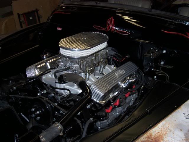

Here is a pretty nasty 462 I build for my '40 coupe.
And, a healthy 389 for my 51 Merc. I made my own air cleaner base to get around the goofy carb spacing.
-Abone.
