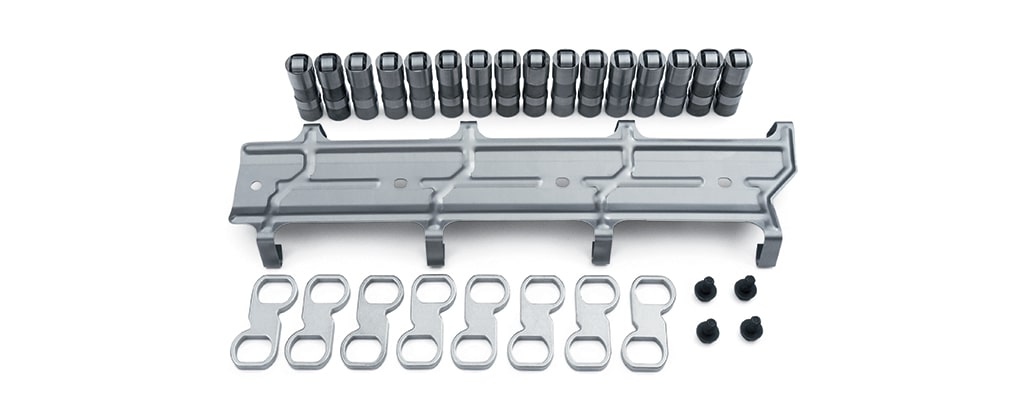

If the 2184 is THE lifter to use, would it make sense to source round .875 ID shims?
Like the dogbones, they'd still need to be fitted to the block, but that's a lot easier
than milling a step into the bottom of a dogbone.

Unless these were epoxied to the block I don't think this works. If they are floating, the "corners" of the lifters will catch these and lift the shim washer and the dog bone up.
