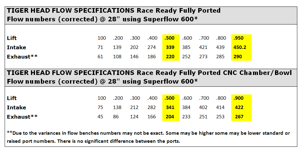

Here is the information posted on the All Pontiac web page. The second set of numbers looks to be for bowl and chamber work only which should be pretty close to as cast.
Jim

AS cast Tiger 1s were 415-425 cfm with chamber and bowl work.2.250-1,800 valves.Full CNC poert was 450-455 with 2.250 valve 462-465 with 2.300 valve..This head is very sensitive in the valve seat area.If done incorrectly can lose 15-20 cfm.Bill C.
