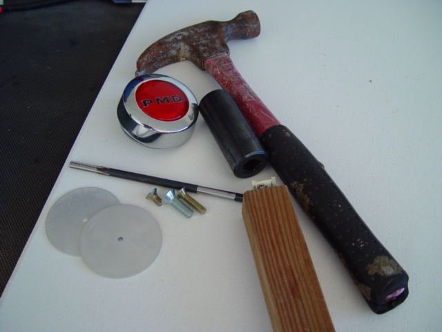

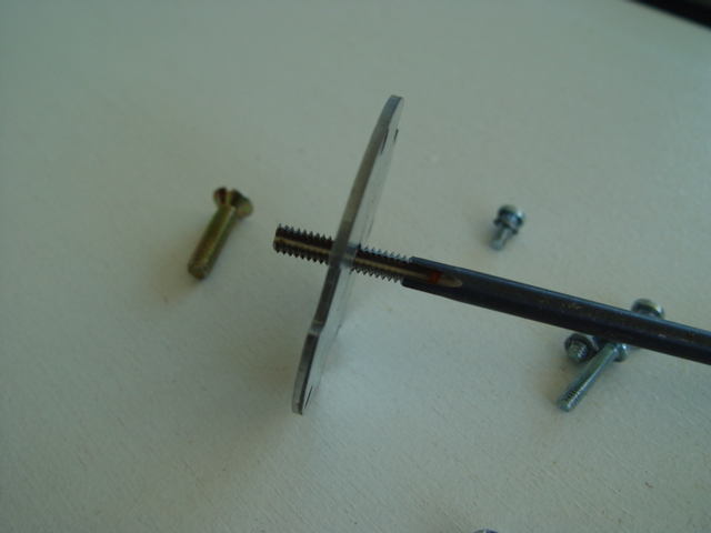

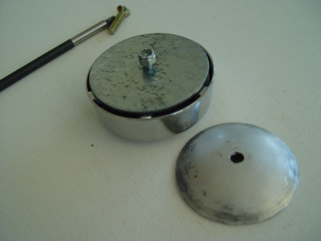

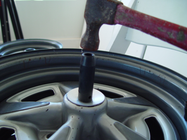

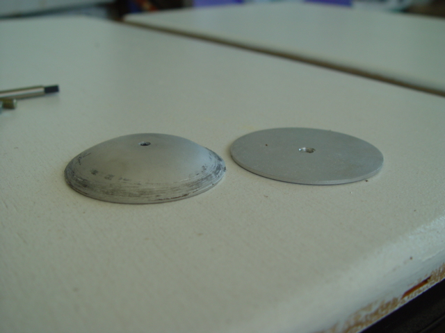

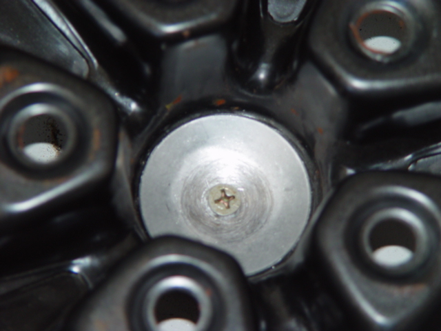

I've had this problem with repro caps on a set of regular Rally II's I picked up from Bill's Birds many moons ago (not JW's or KR's)

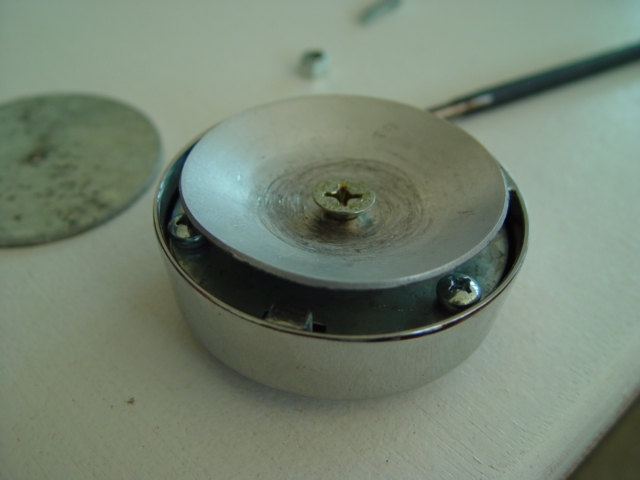

My fix was to pound a fender washer into a dome shape and tap threads into the inner plate so I could bolt it on from behind

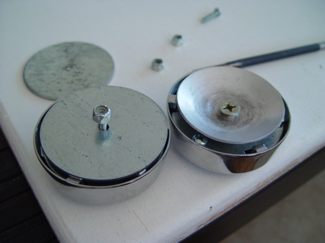

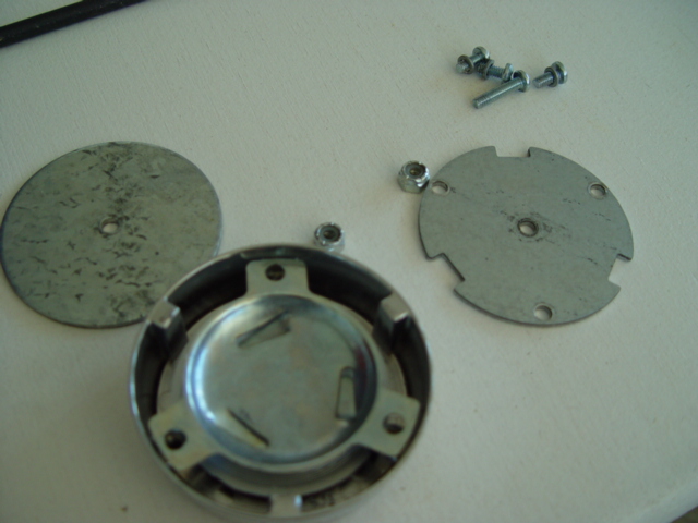

You using the lock, bolt on repop cap? I have modified many of these for members here and others.
My mod is to use the slotted disc and the outside edge screws. I clearance the inside of the disc so it clears the dust cap. GREGGG. May have pics of his I did hanging around.

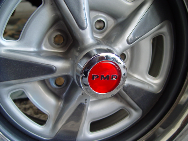

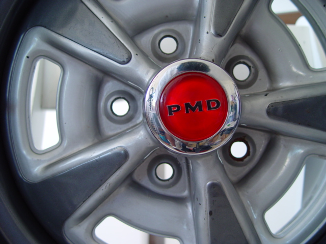

Just curious but what years are red and which are black ? Just looked and my 70's are black with red letters. Also always thought 70 TA RIIs looked like they had put a 14" center/spokes on a 15" wheel. YWTK
I asked this same question a while back
Apparently, for 70 they should be red (I prefer the black)
https://forums.maxperformanceinc.com...php?p=6202208#
And yes, the JW wheels are basically 14" center with an outer ring
My guess is it's a 1970 mid year change so check your production date. If your wheels are original and your car was built late in the 70 model year then all bets are off and both red and black I think are correct.

I think early 70s had black caps.
My 3rd week of March build 70 had red caps.
1970 Trans Am RAIII 4 speed

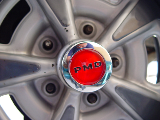

the black to red PMD cap changeover happened BEFORE the "1970+" Firebird started production;
You could get an early 1970 GTO with black caps, but even before the extended 1969 model year run of Firebirds ended the caps had changed over to red (they stopped production of the '69 Firebirds in November I believe; keep in mind that they were being sold as 1970 models and were shown in the background of some images for the 1970 full model brochures).
