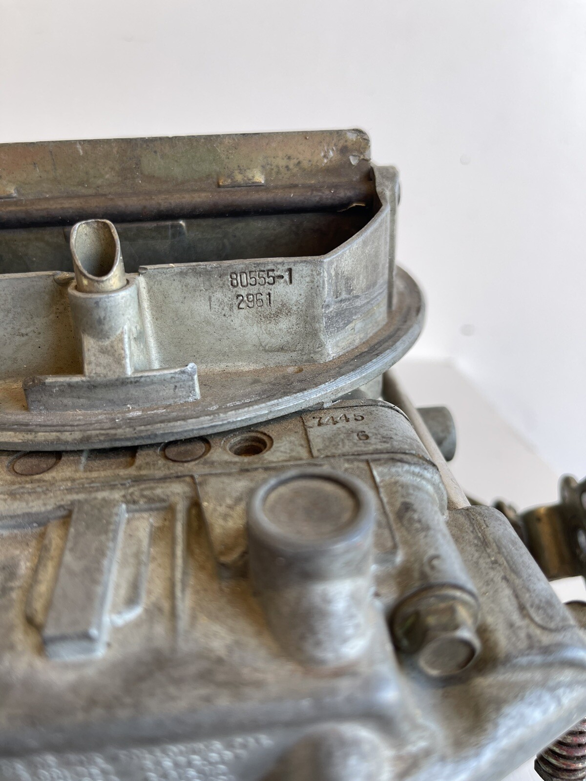

Only numbers I see on the air horn, front of carb, read: 80555-1, and below that is 0327 (date code I assume).
Spreadbore Carb 8055-1 is typically marked only with 5 numbers:
The "List Number" in this case 8055 and the revision number -1 for your carb.
The Carb # is for a 1971-1972 Chevy engine.
There is also a carb with the number 8051-1 that is also for a Chevy.
Look at your numbers again. You have one too many numbers. 8051 or 8055?

My Holley Book for list numbers is obviously out of date for a carb with that high of number.
So the carb, even though it is a spread bore, was built MUCH later than I assumed.
Sorry for the confusion.
The web posts say that some are not happy with that carb. 2 stars out of 5 should tell you something.

So I guess I should trust my instincts more. Turns out the PO had intentionally retarded the timing in order to get it to run halfway decent with a bad carburetor.
Took the car in to a local mechanic and he discovered that the idle mixture screw for the left bank is broken / has no effect. He also verified the crazy timing setting and set it back to 8 BTDC as it should be. Car now really runs like crap.
Off to buy a replacement carburetor. Many thanks to all who have helped me work through this.
Mark
Las Cruces NM
Factory intake doesn't have a "left bank" mixture screw.
Did the mechanic say anything about the metal covering the EGR ports? The way the mixture screws work on that carb, a bad vacuum leak would make a screw non-functional.
Did the mechanic verify TDC on the balancer.
Did the mechanic blow out or clean air bleed holes to try and get that mixture screw to work?
Slowing initial timming for a bad carb makes no sense at all. That would just make things worse.
Need to verify the TDC mark and then, if needed, pull a valve cover and check "cam timing". It can be looked at on cylinder 1 or 6 during overlap. We can get you plenty of directions on here for that.

Posted by QUICK SILVER
I never paid that close of attention to the pic and didn't notice that piece of metal..........it looks pretty primitive and I don't know how it would ever seal the passages correctly.
Here's a suggestion that won't cost too much:
Pull off the carb. Tape off the intake openings with blue tape.
Remove that piece of metal covering the EGR ports. I can't even guess at how it is secured.....
Either get a REAL EGR block-off plate and gasket from Edelbrock (or someone like that). Even better, put expansion plugs into the two holes under the metal piece. You should be able to measure them approximately and then go buy $20 worth of plugs at NAPA or somewhere similar. Use the two that fit and take the others back.
Remove the blue tape, reinstall the carb and see how it runs.
I wish you were closer to Vega$ - we've got a half-dozen known good carbs (Holleys, AFBs and quadrajets) just for situations like this. We'd swap one on and see how it runs. Usually take about forty-five minutes to diagnose and pinpoint the problem.
Good luck!
