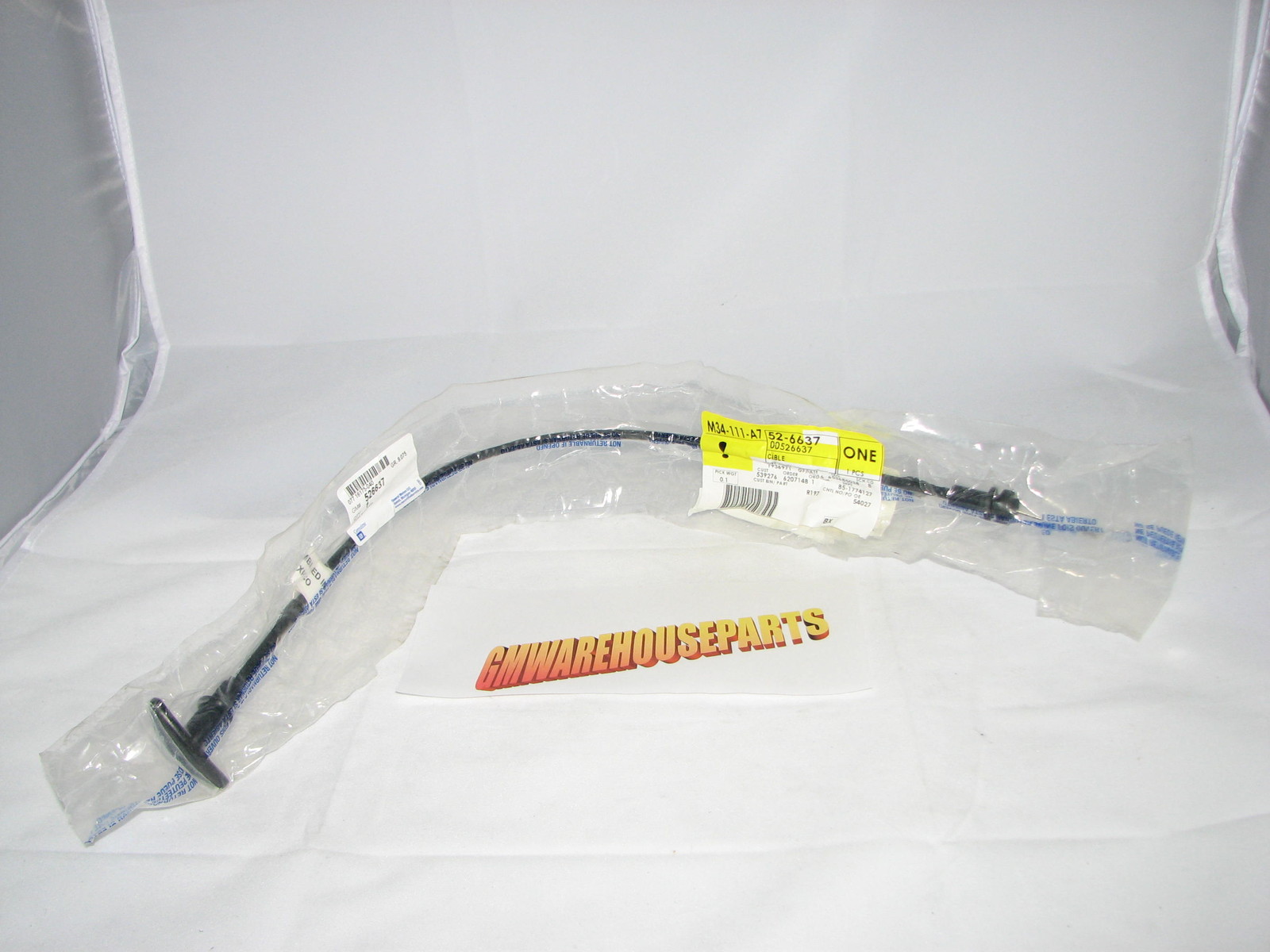

Beat the ripoff nOS prices for Gennie GM...
https://www.ebay.com/itm/26524072306...MAAOSw-29ZS5NF
https://www.ebay.com/itm/17171873146...IAAOxygo9Q9DOd
