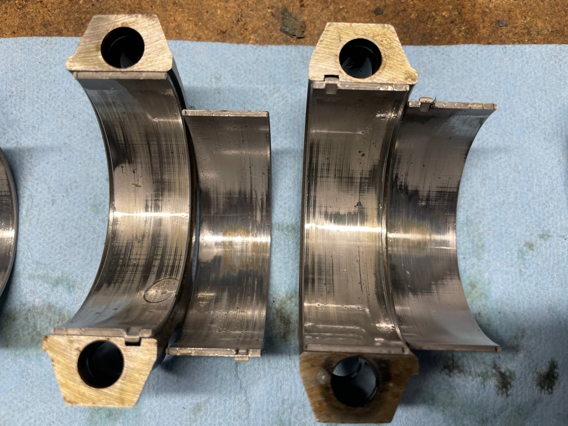

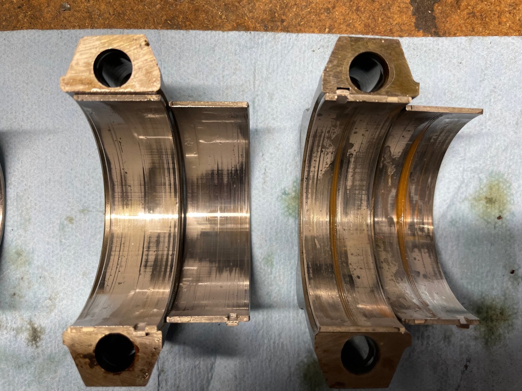

It has a two piece in it now. Based on the oil that was on it when I pulled the cap, I think my suspicions about it leaking were right. I pulled the caps off tonight and I'm not loving what I'm seeing in terms of the bearings, so it's looking like this might be a bigger project.

it looks like too much permatex was used on that seal. Im not surprised that its leaking by the looks of it . You're taking a chance installing the seal with the crank in because you dont know if the block was line honed to the point where the cap becomes shallower then the block side of the main. But yeah you can do it with the crank in . I haven't been so lucky doing it with the crank in.. Looks like those bearing are put in the wrong side . The holes go to the block not the caps ..

I thought the same thing about the holes in the bearings - and the gobs of sealer around the main.

I got tired of the crap rope seal and constant leaking at the rear main seal. My engine is quite modded, and puts out a lot of crankcase pressure that just overpowers breathers so the oil will always push past the RMS and make a mess. So I was able to make a wire tool and carefully pick out and push the rope seal out at the top of the crank w/o loosening all the mains. Then slid in a Butler 2 pc seal. This helped, but I also added a Butler Crankcase Evac System. No more oil leaks.
IMO that the discoloration is not a issue, the crank looks OK but not the bearings.
SO new Clevites, new seal while you are at it, check the rod and main clearances with the new bearings, and your good to go.

The parting areas on the the caps look really discolored .

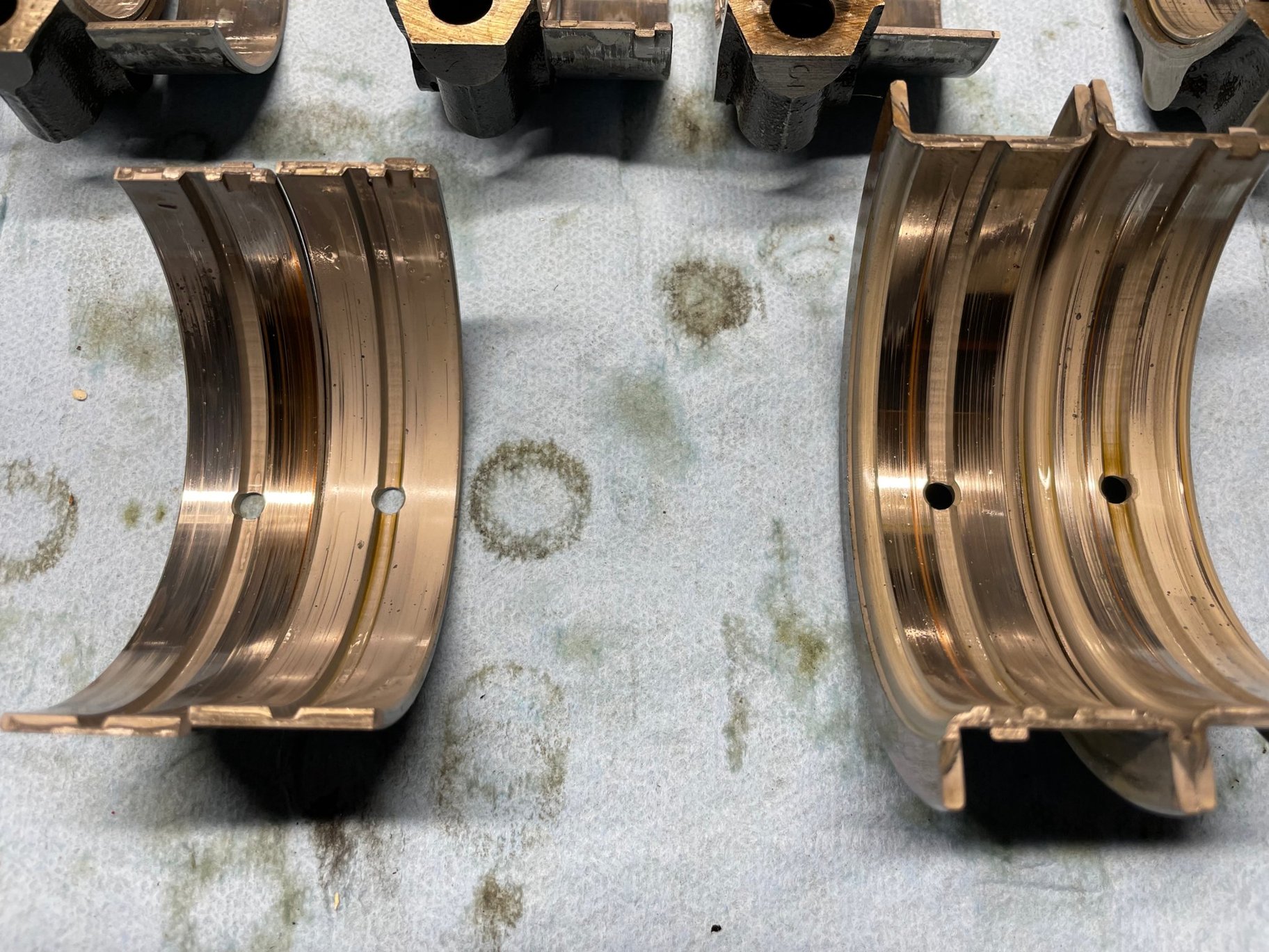

what does the rod side of the bearing look like ?

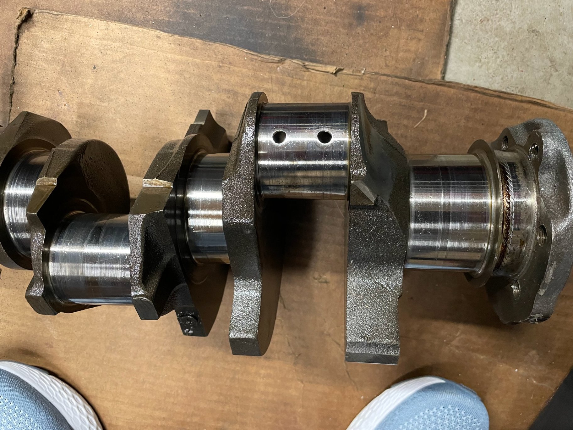

Just an FYI, if going with the regular one piece or 2 piece rear main seal, I prefer to have those serrations polished a bit. Those types of seals tend to not like a rough surface and those serrations can eventually eat at the seal or at the very least wear it down over time. Possibly what contributed to your 2 piece rear main seal leak.

Will get some pics of the rod end of the bearings, but I think they were about the same as the end.

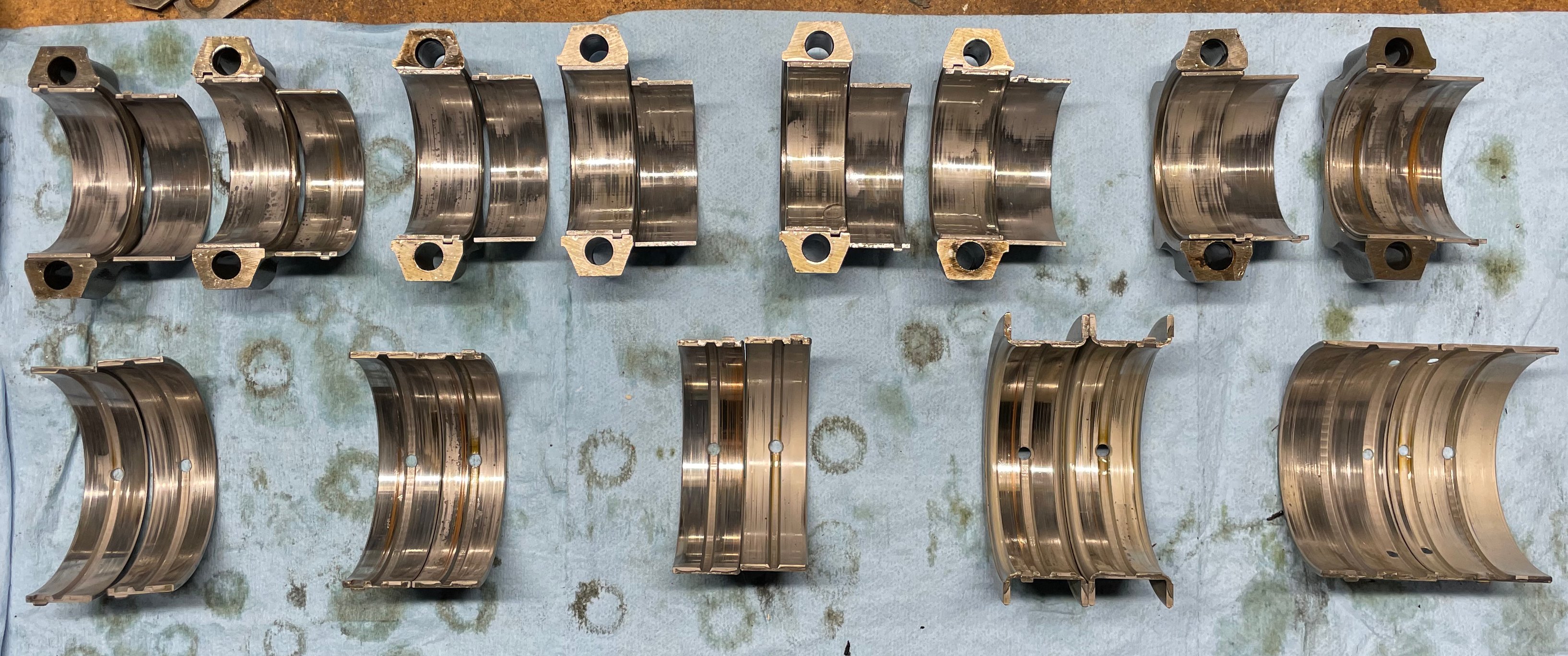

Here's what my mains look like end to end. The middle three bearings are showing more wear. Not sure what that might indicate in terms of clearances or otherwise.
The crank serrations might have contributed to the leak, I've heard they can be an issue. The seal on the whole is hard as a rock. I don't think whatever sealant they used was helping things. It seems to have shellacked over.

Can you show the bearings in the block as well . Im curious what they look like..

Looks like it had some trash run through it.
Are you sure it's been align honed or align bored??

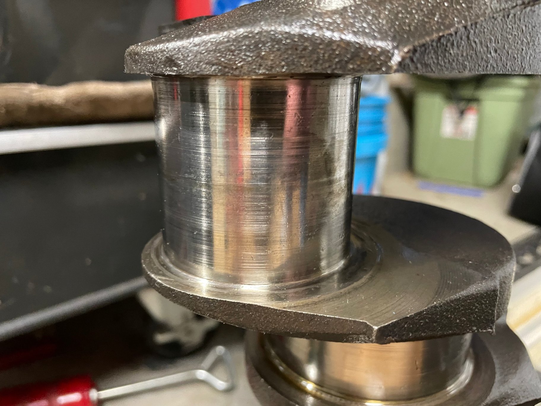

Alright, here' s the carnage. Bearing caps are more roached than the tops, the rod ends are generally hammered.
Crank journals aren't too bad, but will likely need some cleanup. The crank is .010/.010 and the bearings are Clevite 77. Pretty sure I recall the machinist saying he line bored the block. It requires a .005 under timing chain. .010 is too tight, regular set is too loose.
Got some giant pics for you all this time around so you can see the full glory. I thought I'd find a little wear, but nothing like this. Is this a combo of trash in the engine and detonation? It looks bad enough to where I don't think I'd feel good about popping some new bearings in and calling it a day.
