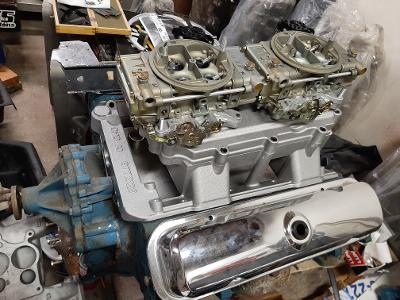

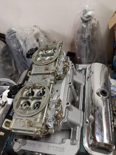

Pictures of Holleys on adapters, if you want that option.

Are those just standard adapters? No mods for this intake? I have a pair of 660’s I thought about using. Looks good.
Actually, with no secondary metering plate, 660’s would fit no problem…..

Standard adapters, 660s will need a little more spacer height for the mechanical throttle linkage they use, I have a pair I tired before I put these 715s on. As their linkage spins that big arm will hit. Regular vacuum secondary and probably DPs usual linkage will clear. The ones I put on I had trimmed the bottom tab off back in 1971 to clear my 409 manifold with them sideways. Recolored and freshened a couple of years ago by Sean at SMI.
