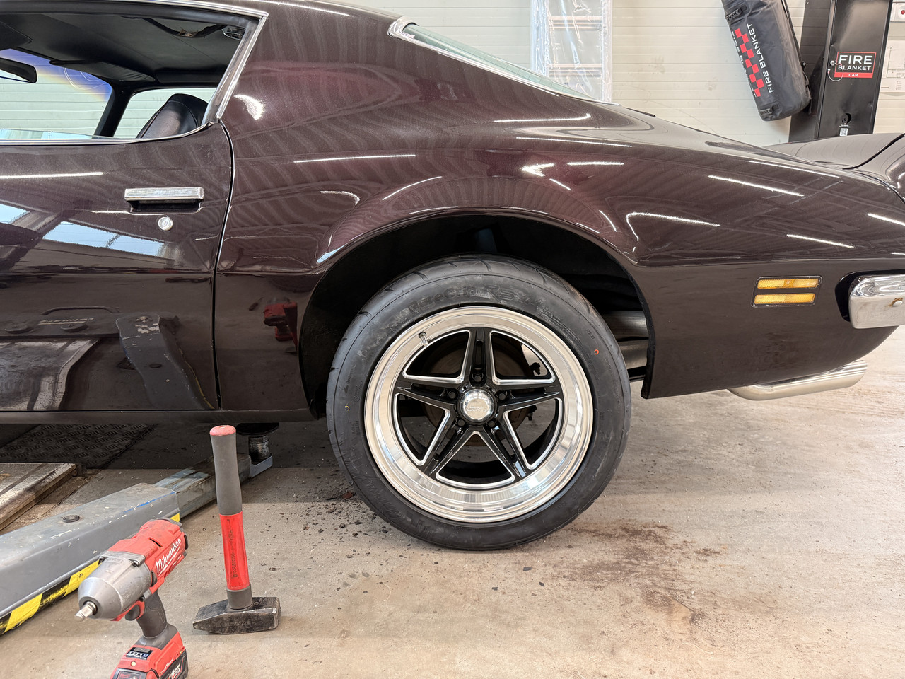

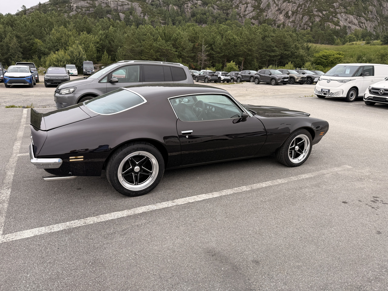

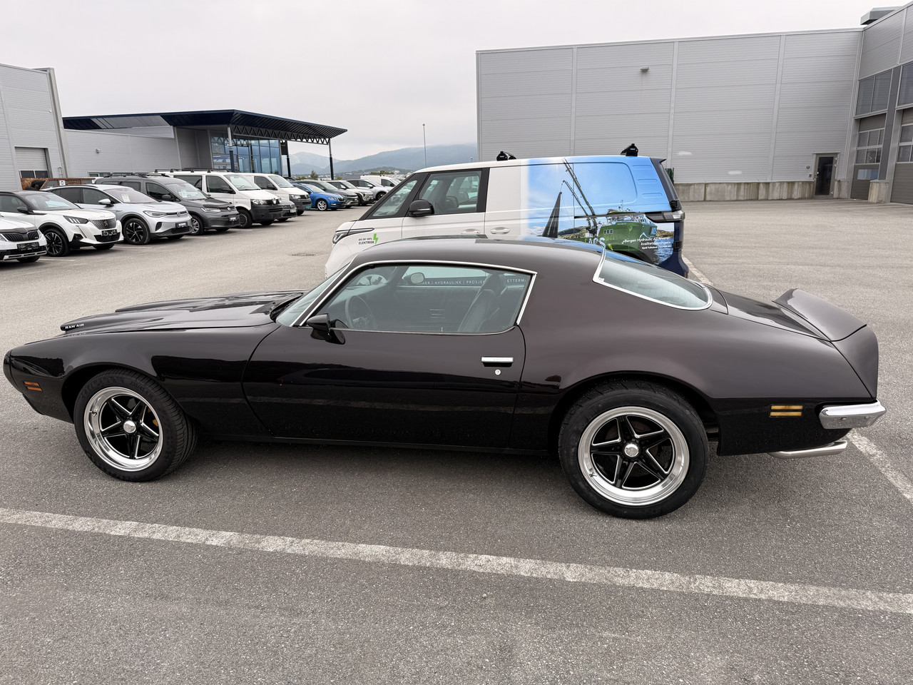

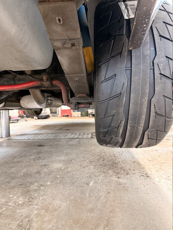

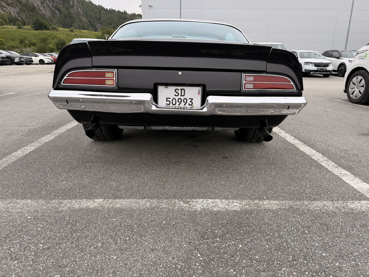

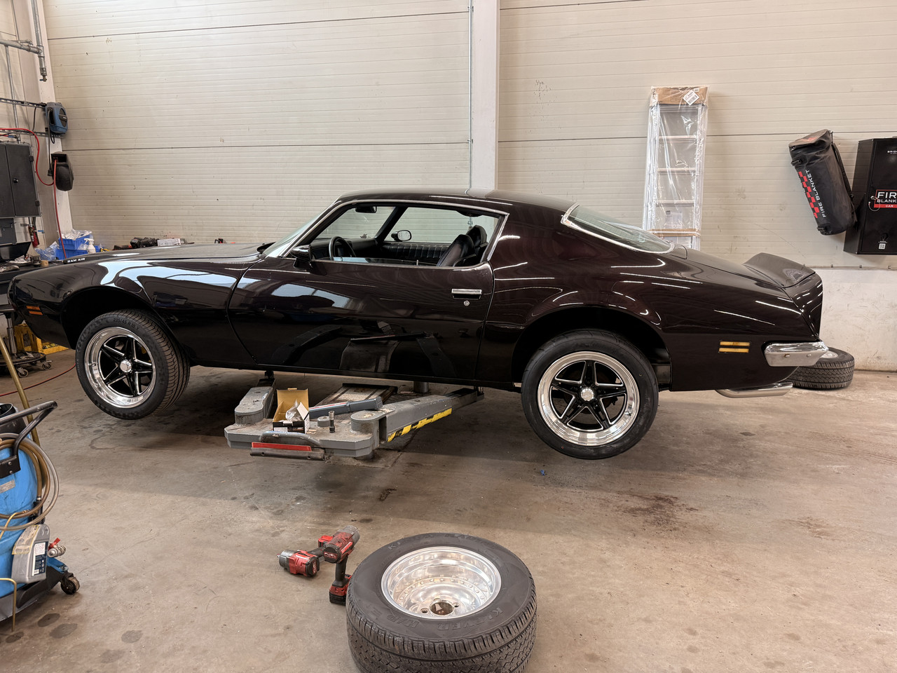

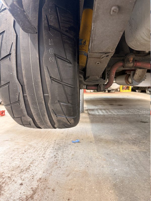

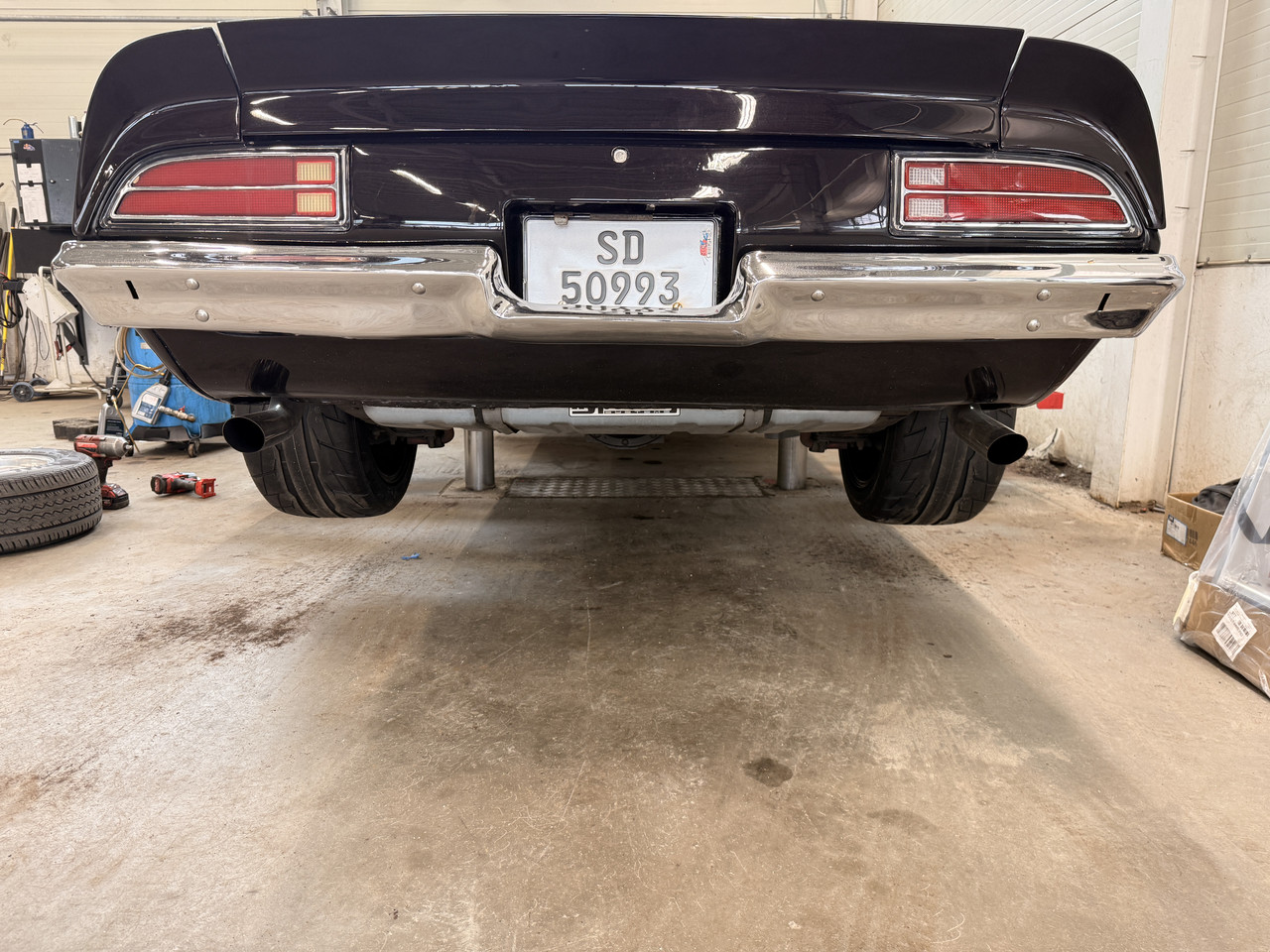

At last! replacemt shipping from summit arrived, once they sendt out replacement wheels it got here fast. I did have to use a BFH on the seatbelt bulge, i did a quick lap around the shop to check for clerance, no rubbing so far, but even after using a BFH i can get a lubed up finger between the seatbelt hump and the tire if i use some force, maybe 1/2" - 3/4" clerance.

245 45 18 front on 18x8 inch wheels, and 285 40 18 rear on 18x10 wheels. Lowered a bit and clears everything after BFH on seat belt bumps. After rears are finished will see if the same hammer can make room for 295 40 18.
