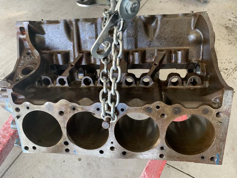

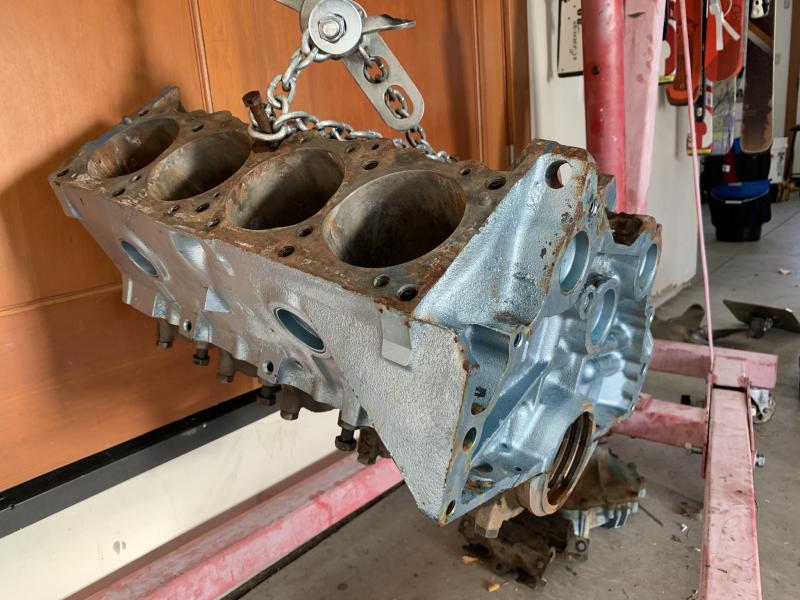

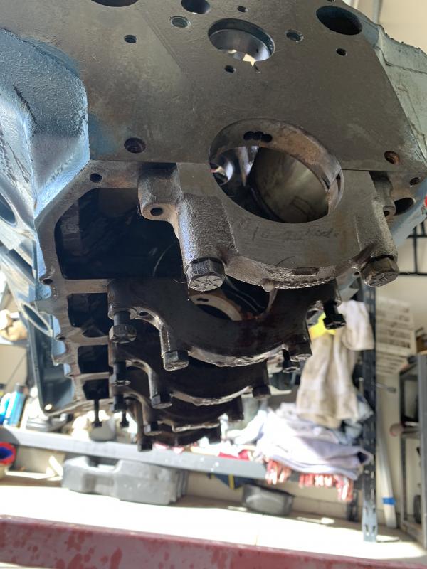

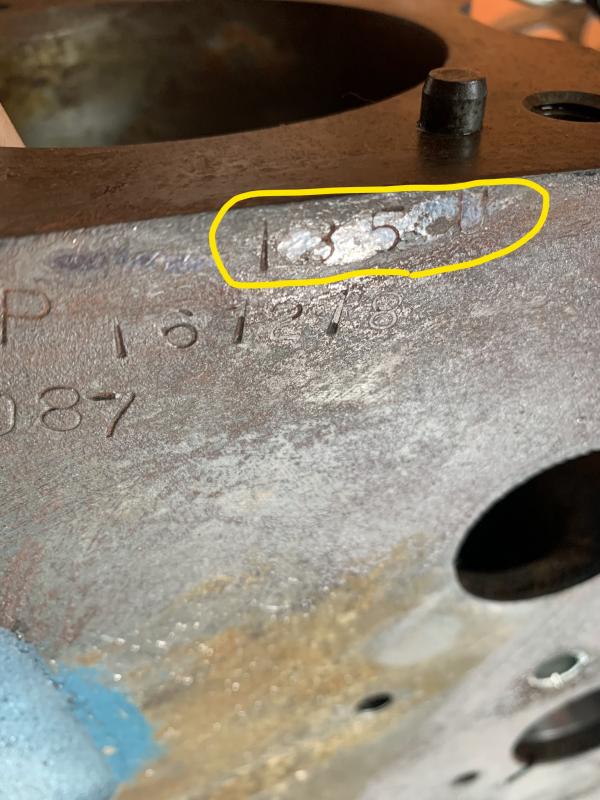

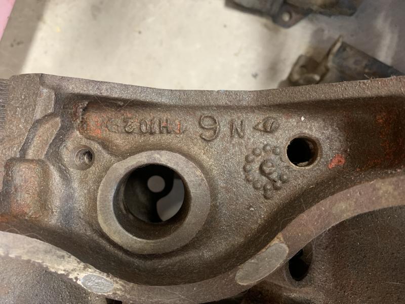

Hi guys, my father in law passed away and I inherited a 1963 Pontiac 421 SD block (or what I was told). I don't have the background or knowledge to tell if it is legit. Would you mind looking at the pics and giving me your opinions? Appreciate it!

Type 135U in the engine code section.
And yes that should be a SD block.

135U is the engine code for a 405hp 421SD engine, manual transmission, dual four barrel carbs.

Looks like amply boss broke Ken off for the bell housing?
