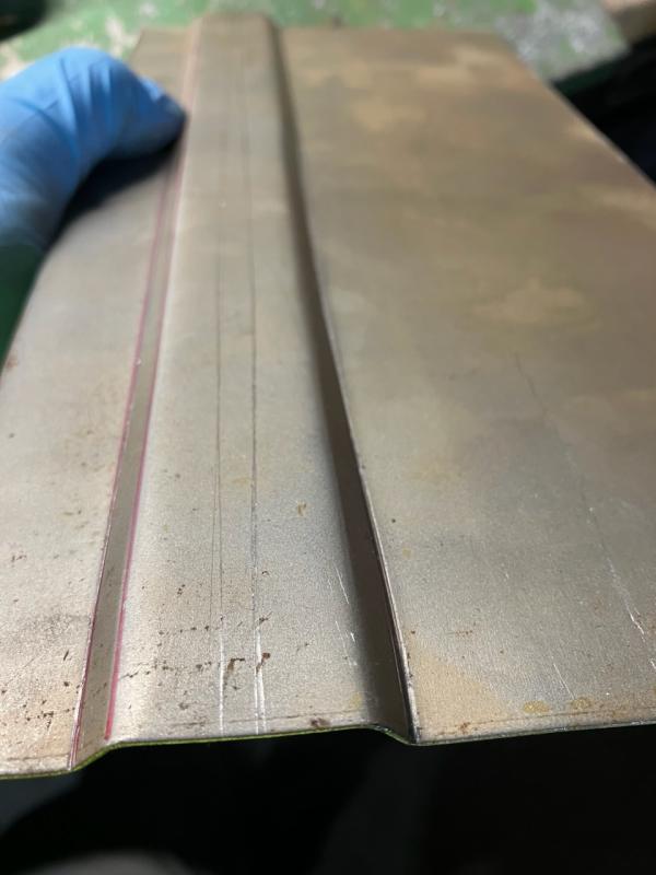

Feel like I’ve stalled out moving forward while I’m still waiting on those supports. Took the last two days to build a guide fence for my bead roller and also started playing with figuring out the profile for the trunk ribs. I have to extend my patch section forward towards the rear seat area just a few inches. I’m still trying to keep some progress going.

I’m definitely grateful for the tools I’ve collected over the years! I wish I had more time to use the bead roller for other projects, it’s a fun tool to mess with. I need to come up with a pair of flat roller dies but one of the tools I’m lacking is a decent metal lathe to make them.
Made a little progress last night (trying to take advantage of the warm spell here) but still waiting on parts to arrive.

Thanks for the kind words guys. It’s the machines and not me. I’m still getting things dialed in since switching to my HTP TIG machine. I probably did close to 30 linear feet of 20ga sheet strips this past weekend just trying to sort things out. I finally settled on some crazy pulse settings (115A, 0.8P/S, 10% D, 15%BG) and it stays cool and practically welds itself up lol. Fresh metal is a dream anyways so the real challenge will be patch to body panel seams.
That bead roller does way more than I expected for a budget model. I spoke to Heck Industries today and they’re shipping me out a few sets of flat rollers they had manufactured in the past for exactly what I want to do. Great guys there. They manufacture for Woodward and maybe some smaller house brands.
