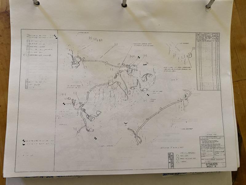

Questions for the team. Trying to figure out the correct routing of the healight harness and ground location on the basket case bird. That particular page on the manual is so faded I cannot tell exactly where things go. Here’s a couple of pix of the areas in question. Thanks in advance.

The forward light harness runs atop the passenger inner fender well and has I believe one or two push clips that slot into holes on the wheel house cover itself. The Grounds attach to the upper filler plate of the nose section. There should be notches there that the grounds come up through the bottom. They will be located about 4-5" inboard of the fenders.
Based on your pictures and the current status of front end construction, I would simply lay that harness out in its general location for now. When you get the driver wheel tub in place, you can run the harness there. When the front end goes on, you can complete the harness there.

Thanks for the response. I'm really looking for specifics in the areas pictured. Pass side there are a few locations where the push clip on the harness can be installed to the core support of the extension. It appears that the grounds loop around to the opposite side (radiator side) of the core support (over? under?) the extension and a screw into one of several similar sized holes to attach.
Driver side, yeah fender well is the easy part.. Same as pas side for the grounds and it kind of looks like the push clip of the harness itself goes into the hole halfway up the extension sot he harness would go up and over the extension at that point?

I highly recommend that you purchase a factory assembly manual for the 69 firebird. It has detailed images along with the part numbers.

Yeah, here's the page showing the installation.

I got my questions answered. That page of the manual - SUCKS.
