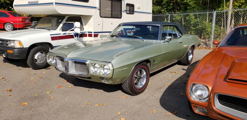

My brother, Dan, has a ’69 350 HO Firebird (100% stock) and I have a ’69 350 HO Custom S 4-dr sedan (also 100% stock) that each have measured 9.7 to 9.9 to 1 static compression ratio cold and 10.0 to 10.2 to 1 hot with the Whistler box. The Firebird is a 4-speed car, so has the factory 068 cam, and the Custom S is an automatic car, so has the factory 067 cam. Dan ran both engine set-ups on the DeskTop Dyno, and the 067 cam made the same hp as the 068, but with 10 lb-ft more torque. So, don’t over-cam your 350. Both cars have the std. 3.55 gears with the optional HD Safe-T-Track limited slip.
Dan built and dyno’d a ’69 350 HO intended for the Pure Stock Drags way back on 2006 with 10.6 to 1 compression and a 067 inspired custom ground cam (201/217/110 at .413”/.424” lift) that made 342 hp (@5300 rpm) and 403 lb-ft torque (@ 3700 rpm) through the log exhaust manifolds and 2.5” mandrel head-pipes.
Your ’75 350 4-bbl needs 9.0 to 1 compression minimum to run well with anything more than the 2800 Summit cam, which requires different heads like 16’s, 62’s, or 13’s with a chamber around 78 cc’s.
Dennis

Thanks for posting! That's a lot of solid info. How do these cars perform in the 1/4?
The Firebird (4-speed M20) has run 14.30's @ 98+ mph. The 350 HO is still std. bore, but with a re-ring and new bearings, new Ferrea SS 1-pc valves and CC springs (115 lb. seat/275 @ .450") shifting at 5000 rpm. It weighs 3560 lb. with driver, full tank of fuel, and spare tire/jack in the trunk. (It has somewhere around 50,000 +/- original miles).
The Custom S hasn't had a chance to see any action yet as we just acquired it this past January and are trying to finish up the interior and exhaust. It likely will weigh in the 3900 lb. range race weight (w/driver, full tank of fuel, and complete spare tire & jack in the trunk). The 350 HO was rebuilt back in 1975 when the nylon timing gear sheared and must have bent some a valve or two, because there is a picture of the original owner standing in the engine bay in 1975. We aren't sure how it was rebuilt way back then, but it does run well and now has 72,000 miles on the odometer. There is a thread in the 68-69 GTO Tempest & Lemans TECH forum called "ebay 1969 4 door Custom S 350 H/O?" that follows the work we've been doing on it. If I had to guess, I think the Custom S could turn 14.5's at 95 mph once dialed in.
Dennis
