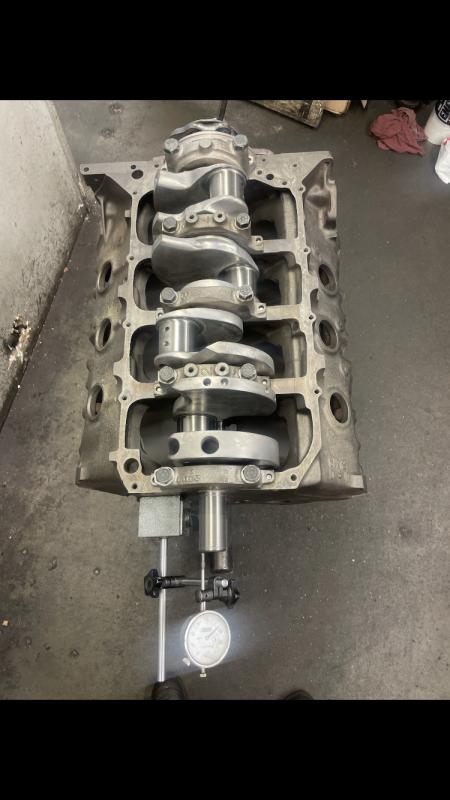

This is my latest crank to go in my next engine.Forged,3in main 4.21 stroke BBC Rod Js.Been lightened(2 slugs of Mallory).Bull nosed leading edge and knife edge trailing edge.No clue who made it.Marine Crankshaft checked it out and gave it a OK.Tom
The Following User Says Thank You to tom s For This Useful Post:
