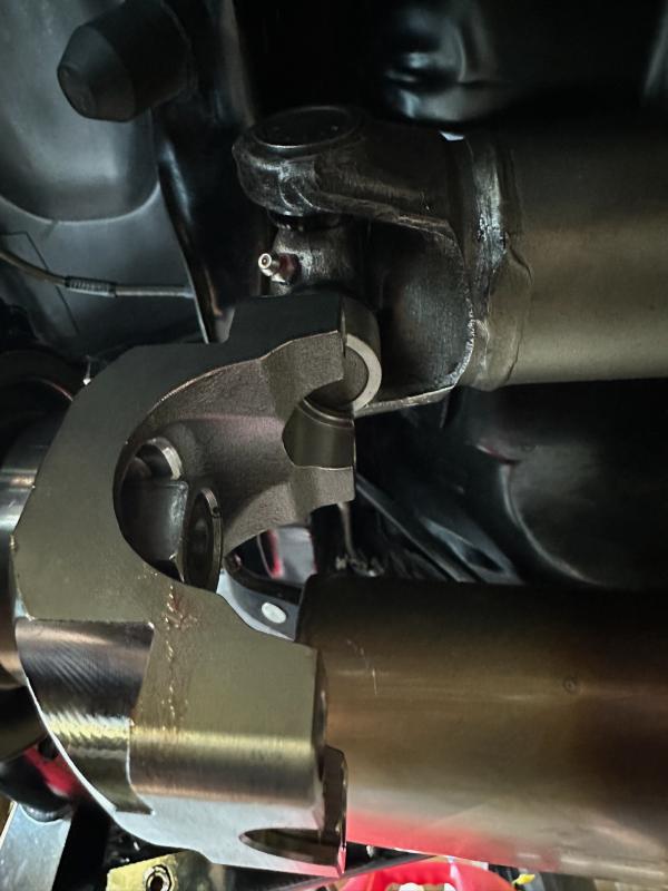

Almost have the new Moser 12 bolt rear and Global West suspension installed. Aside from a few missing odds and end, it's been going smoothly. I installed a new 3R/1350 conversion joint and went to reinstall the driveshaft this evening. Not so fast. Looks like I need around an inch or so shorter.
I thought that 12 bolts were a direct swap, but I guess Moser changed enough stuff that this one isn't. My hunch is that fat 1350 yolk is a culprit. Guess I'll be ordering a new driveshaft.

It's most likely that 1350 yoke doing that. Ive noticed some of those being as beefy as they are do stick out a bit further as well.
As far as a 12 bolt being a direct swap, yes. Dad's goat still had it's born with driveshaft when we removed it's original rear and swapped the 12 bolt in, the driveshaft was a slam dunk.
When I later upgraded the 12 bolt to a 1350 yoke I also had a beefy driveshaft made at the same time with 1350 ends and a billet trans yoke.

Honestly, by the looks of that shaft you have now, you NEED to replace it. Those look like OE ends.
And if you are, might as well spring for a new slip yoke too.
Pretty certain it is due to the rear yoke. I bet if you got a standard one it would have fit.
Overkill is usually safer anyway, and you've already done the rear, so a new shaft and you will never have to worry about it.

Slip yokes also make a big difference in length. I had a 48.5" on the Camaro/IA with the SBC and stick. IA and TH400 it was too long to fit.
Mark Williams measurements using their yoke ended up 48.5"!

Yes, I’ve been running the original driveshaft. I was going to run a conversion u joint which I figured would be fine for a while. I ended up ordering a new 3.5” steel drive shaft with a new yoke from Inland Empire Driveline. 1350 on both ends.
I measured, re-measured and re-re-measured before calling them and talked through how no measured on the phone with them. I hope the bigger diameter fits with where I have the x-pipe. The stock driveshaft was pretty close.

The new driveshaft fits perfect. I don't think there's any risk of breaking this beast! Plenty of room around the x-pipe. It is heavy though. I kind of wish I asked about aluminum.
