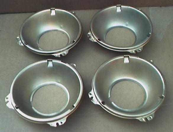

Here's a photo of what they should look like. Cad plated with the gold irridite finish.

Some NOS Service Replacement Parts were painted a Semi-Gloss Black, but most of the original ones on assembled cars were the color that Joe shows in his photo.
