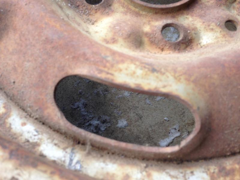

I'll preface this by saying I've never owned a Rally I wheel, and maybe my information is outdated, but I have an article from Classic GTO magazine (remember that one? Lol) from September 1984 that says they had a different wheel for disc brakes, but only produced it for a short time and went back to the standard Rally I. The only difference was the slots in the wheel. That would suggest that any Rally I will clear disc brakes.

Years ago Dick Kreiger had a pair of disc brake rally ones at several swap meet. The slots were tapered and the wheel was side specific. Only time in 40 plus years of doing this seeing these wheels
This is correct, a friend of mine has at least one or two of them.

I remember going to one of the Carlisle PA swap meets in the 80's, and one of the used parts vendors had some Rally I wheels with the odd scoop shaped flares on the 6 openings. It didn't look home-made, but I was still dubious that it was a factory thing. In fact, it seemed almost like the stamping machine that made the center section was a little bit offset to create the asymmetrical opening for the holes. I've wondered about those "disc brake Rally I" wheels ever since. I've never seen a factory media reference to that kind of special Rally I. I'd love someone to shed light on this!

Here's one I took pictures of at my buddy's place.
Directional brake cooling scoops.
Never seen anything like that before, pretty wild!
Talk about a rare Pontiac wheel.
