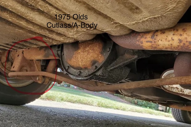

Did Olds/Buick use these on other body styles as well in 71/72? Or could these be from a ‘73+ A-body? The upper control arm mounts are stock, but looks like the lower control arm mounts have been moved ~2 1/4” outboard to fit this ‘68.

Coil spring '73-77 A-body/'77+ B-body housings had inboard shock mounts as part of each lower control arm mtg bracket. Earlier A-body rears had outboard shock mounting. The oddest outboard shock mounts were on 8.5 A-body housings used on the housings in VistaCruiser wagons.
It looks like someone has crudely cut off that area on each of your lower control arm mtg brackets, that makes me believe it's a '73-77 style coil spring housing that the shock mounts have been modified.
The spread between their upper control arm perches on the '73-77 housings is several inches wider than on all the earlier A-body rears. I once ran across a '70 ElCamino where the frame crossmember area where the upper control arm mounts, had been cut out, & a section cut out of a '73 & later A-body had been welded in. The other fit problem with the '73-77 A-body rears is they are little over an 1" wider than the '71-72 8.5 A-body rears. With the factory drums installed, the width of the '71-72 8.5 A-body rears are 61 5/16". '68-72 10 bolt & 12 bolt "Chevelle" rears are also very close to that width with drums installed.

I think OPH nailed it. ‘73-‘77 A-body.
Looking at your photos Schurkey, and the ‘75 cutlass photo below, I can see how that bracket has been cut apart to separate the control arm and the shock mounting, and then welded back together on this differential to earlier 68-72 layout.

I’ll have to check the overall width again to get a more accurate measurement, but it’s about 55” to the inside of the axle flange (this diff has been converted to rear disc, so no drums to check overall width). And it’s about 7.5” between the insides of the mounted upper control arms (I don’t have another 68-72 A-body diff to compare this against so don’t know if this is a lot wider).
