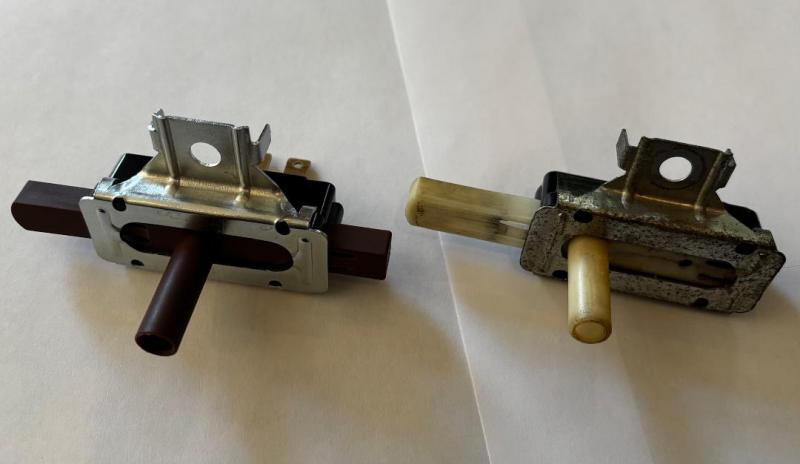

Ok so this is what I got. Purchased from the link I posted. Looks like junk to me. I feel no ratcheting or hear any clicking in the movement. There is no tab to push so that it will set to the initial position. It won’t even travel the full length of the slot. Won’t even click into place when it hits the end of the travel. It just springs back and forth with a slight metal rubbing sound.

1981 Trans Am project -YJ 400 stroked to 488 CID-74cc Eheads-10.95:1-Northwind Intake-Holley Terminator-TH400-3:55 Moser rear-Dougs Headers....

The new one on the right will not travel to the position of the older one on the left.
In fact I can also see now what is wrong with the old one. The small plastic tab on the white slider won’t keep the switch from going all the way forward anymore. It is constantly slipping back into the initial setting mode.

I was able to “modify” the old one to work as intended. Only took 5 minutes now that I see what was wrong with it. I indented the end of the metal housing where the red circle is with a punch and hammer to catch the little tab when it snaps back. Then I had to use a utility knife to carve out the plastic on the slider where the blue line is to keep it from rubbing on the indented metal. It now is able to be pushed into the initial setting mode and won’t snap back into that position after the gas is released. And YES after it is pushed into the initial setting you can hear the soft ratcheting/clicking noise as it takes the final setting.
If someone can tell me how this new brown one can be pushed into the initial setting mode I’ll try it in the car to see if it also works but I’m betting the old OE stuff will be better even if modified.

For final clarification of the issue with the new kickdown I will place these pics in one post. These switches are not identical in their function.
The first pic shows that on the new one there is no tab that needs to be depressed to force the switch into an initial setting.
The second pic shows how far to the left the switch will travel. It will go no further with any attempt short of possibly breaking the unit.
The third picture compares the two switches showing how the original switch will go into initial setting mode when the tab is depressed.
Like I said it’s like the new brown switch is simply on/off and has no provision for an initial setting for pedal travel.
If someone knows how to set this new style switch for an initial setting please post. No it will not slide into an initial setting by pinching the plastic slider.
EDIT. The washboard function of the old switch is intact and non existent on the new switch an no the brown slider will not reach the end travel of either side of the slot.

This switch will not “slide” toward the firewall. It will ONLY push forward with pedal travel and then spring back to center.
I respectfully disagree. I just did a search for th400 kickdown switches and there are many out there that look identical to what I just purchased but I have found several that claim to be new old stock that have the small tab on the slider. I believe the ones being sold new are not the same part number and do not function like the OE equipment was intended.

You’re not understanding me. It won’t move toward to firewall from the center position at all. So it won’t take an initial setting. The pedal arm only contacts the switch at almost full travel. I think im done explaining. I am going to purchase a NOS switch (not cheap) to have one in my parts bin. They are obviously not making the correct ones anymore. Thanks to everyone who has tried to help on this thread. I think I have all the answers I need now !
