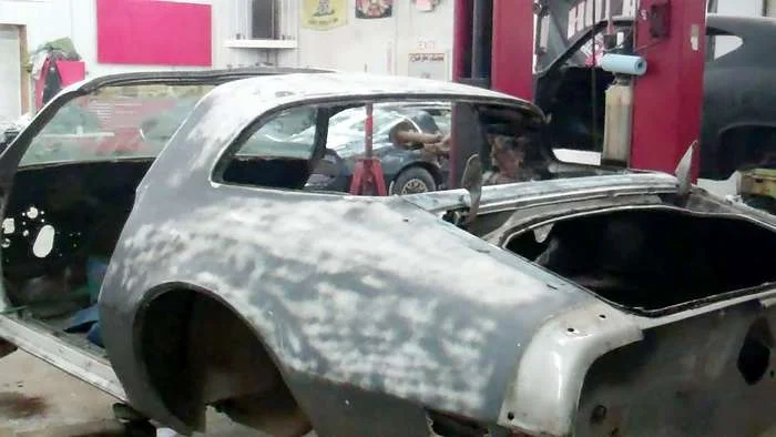

Here's a car undergoing restoration with the third hole I'm talking about above the marker light, which is exactly where that spot with the adhesive would sit:
This third hole is noticeably larger in diameter than the two mounting stud holes, so I think it's meant specifically for this adhesive.
