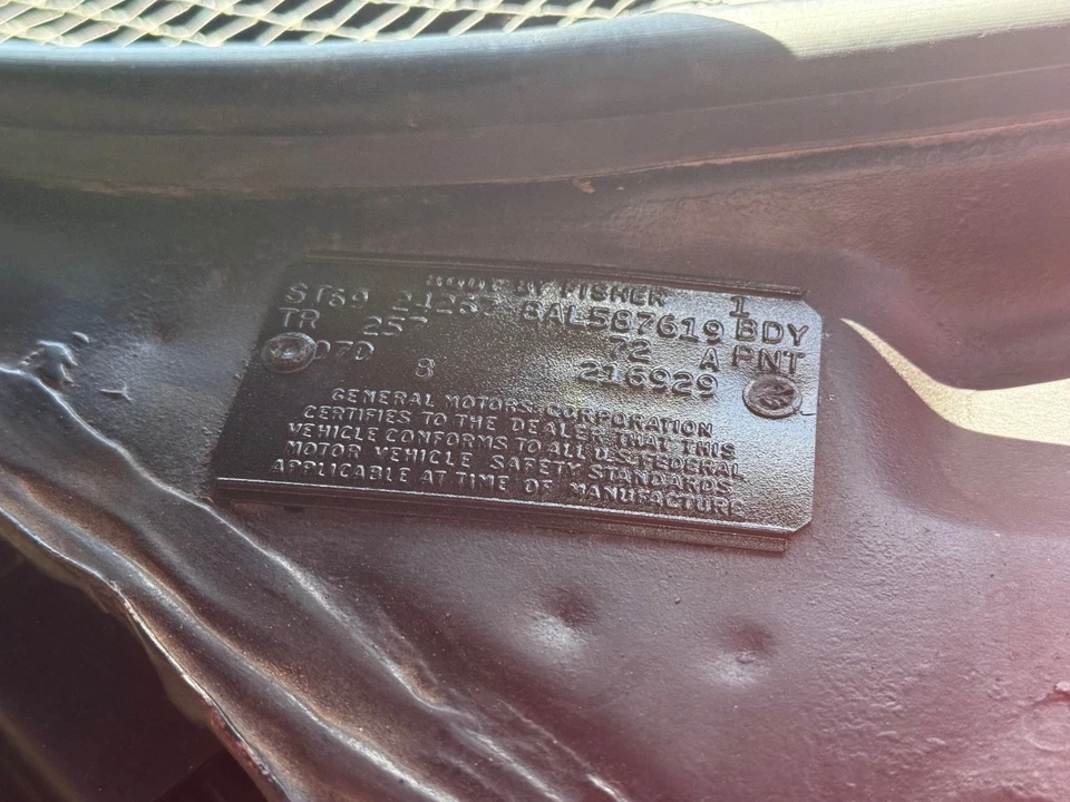

Repop Trim Tag forged to fool , different paint depth color and texture than rest of the black cowl paint

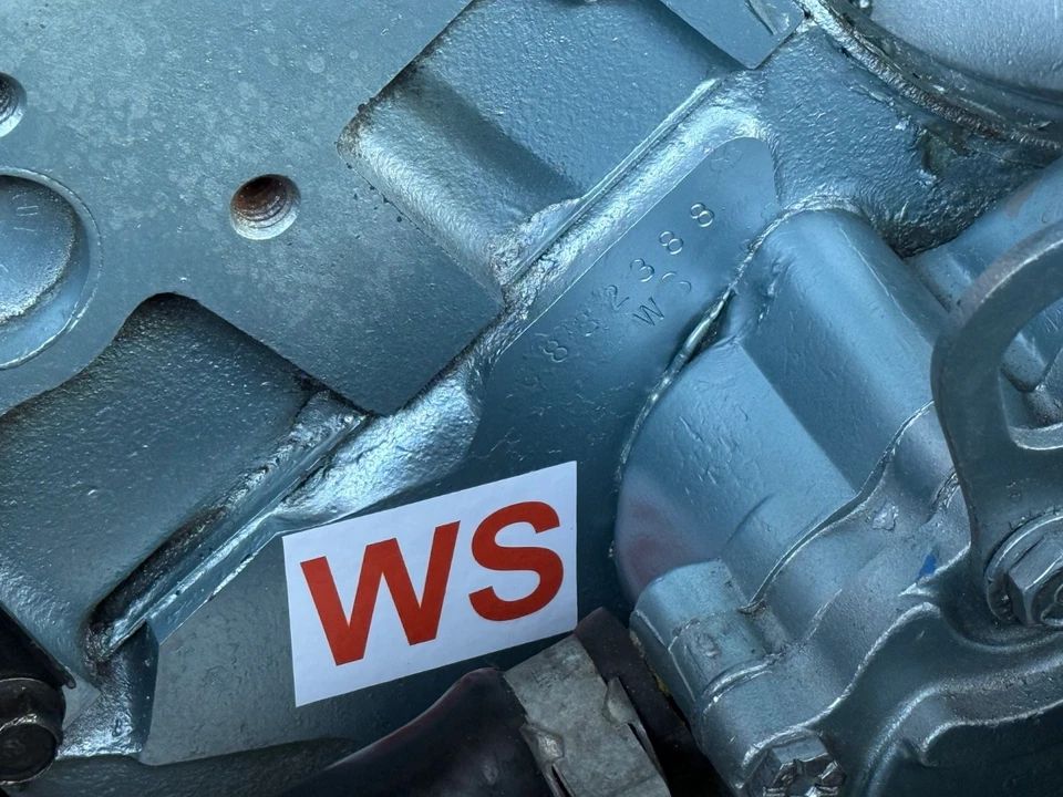

Bend over and say ouch ouch ouch ouch ouch ouch ............

Interesting story. If I was purchasing a rare car with high value. I'd double ck all the info. Call for PHS myself. Visit the car personally. If possible bring sheriff or state police with me to see their reactions.Not be in a hurry. There is always another car available. I'm no expert but those rivets look funny,like not original looking.
Old 07-13-2025, 03:11 PM
The rivets are excellent reproductions.
And the reproduction trim tags are getting pretty excellent too.
Where they always screw up is not making detailed close up pictures of how the putty in the original rivets looked before they removed them.
They just mash stuff in there and call it a day.

And Rookie restamp on the block code.

The block stamping would make me curious. The W is very pronounced but the 2 letter isnt. I could believe initial stamping but I would look closer.At all the numbers and get info from a Judg expert.

Another quick clue is Rally 2 wheels were not an option on 69 Judge , they were standard equipment.
Fairly recent swap job..
Restamped WT engine block to "appear" as a WS
The only thing that could look worse would be a polished trim tag.

I swear I can see a T in that S…

Faked repop trim tag that is 5 months off from the VIN.
https://www.ebay.com/itm/26732216893...4AAeSwoR9obtZm
But the VIN does match the PHS , and the PHS appears legit.
Was a Pattern Judge , must have been a zone use car originally , and re-billed in July.
They went by the Invoice date to get a trim tag made.
That means they didn't have the car , just the VIN plate.
02A by the VIN of other Framingham Judges in the Registry
Brand New 07B tag on the car.
ID:	654313   Click image for larger version

The forged engine stampings on the convertible are laughably bad.

Default Motor Vin
Lower motor Vin with last 4 digits stamped looks legit. I have seen motors stamped like this. Heavy on the one side and the rest was unreadable. Have seen many very light on left side with first three letters not seen. Many no stamped motors that were original to car. I can still see the circular broach marks from GM's circular broaching mill. No one does that type of broaching anymore.
Motor sequence number looks legit. Agreed the S is suspect. But the W is correct. Very odd. So the theory of a forged paperwork fits. They had to forge the Judge on the PHS to get this to work out. To bad the original GTO conv 4 speed is worth a little money also but not Judge money.
