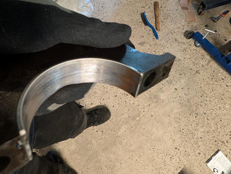

From your picture of the bearing it shows that there is or was a lot of fine grit in that motor and the fact that each bearing near its ends show no ware means that the rod bore is out of round to some degree.
That condition can lead to spun rod bearings and potentially a rod failure which 99 % of the time takes the block out.
How many rod bearings look that way?
Before you take the crank out to look at those bearings check the crank end play and note that down.

Originally Posted by Mikael Nielsen View Post
I have now aligned the crank and the cam as good as possible, and is now trying to turn the piston.
While removing, I noticed the upper rod bearing having some small scratches. Are these okay? Or do I need to replace all of them?
The previously owner replaced them all, but I am not sure if it's damaged.
Picture attached
That is a lot of bearing damage if it only ran for a few minutes. As one of the other guys said, that indicates there was contamination of the oiling system when the engine was built. Check some more bearings for the same condition. Any bearing with that much damage should be replaced. If I saw that in an engine that was removed from the car, I would fully disassemble the engine and clean the block's oiling passages. That level of bearing damage is unacceptable for a motor you want to live a long time.
Also be aware you cannot just turn the rod around to fix the orientation of the piston. The bearing chamfer must face the outside of the rod journal. Usually this means having a machine shop press out the wrist pin and correct the orientation of piston to rod. Is this the only piston that is backwards? The notch or arrow on the top of the piston must face the front of the engine, and the chamfer on the big end of the con rod must face the outside cheek of the rod journal. The prevents the rod bearing from contacting the radius at the journal's edges where the crankshaft journal meets the edge of the crank throw.

I have now removed all the rod bearings and pistons. It's almost the same on all of them.
I measured the crank play before I removed one of the main bearings. It showed 0.0078 inches.
I have attached a picture of the bearing and crankshaft. I guess I have to order new main bearings also with new bolts..

That crank absolutely needs to be polished or maybe turned to the next undersize. A quick check is if you can catch/feel your fingernail drag on any of those grooves on the journal, the crank must be machined.
Those journal surfaces are not serviceable as they are. The brown wear mark between the rods bearings indicates long term wear. This crank was not machined properly the last time the engine was built. I would say the bearings are also too tight, but without knowing the condition of the journals beforehand, or knowing if the oil was contaminated, it hard to say why the bearings were moving metal the way they are. The contact patch looks too long on the main bearings, so I suspect the main bolt torques were incorrect. What size are those bearings? Are they marked STD or some undersize on the back side of the shell?
The correct way to figure bearing clearance is to mount new bearings into the main caps and torque them without the crank in place. Measure the internal diameter of the bearing inserts with a dial bore gauge. Use those measurements to determine the exact diameters to machine each crankshaft journal to achieve the desired oil clearance of .0025". That's the way the pros do it. The easy way is to just turn the crank journals to the next undersize, but the actual clearances can be wrong/scattershot doing it that way if the block is out of spec.
Your next job is finding a very good machine shop close to you. Do not order any parts before bringing that crank to a machine shop.

Damn. As I feared.. I will get in touch with the machine shop.
Strange thing is, when I tried to loosen one of the main bearings, it was almost completely loose.
But thank you for the long explanation.

Those Pistons will not survive if the wall clearance is too great and with signs of grit that has gone thru that motor the piston skirts might be worn .
Once again have everything checked out before you go spending money on heads that you might not need.
On aside note if Rods are stock I would plan on replacing them, not rebuilding them.
All your decisions need to be based on how hard it might be to replace that block where you live if a major failure takes place.
