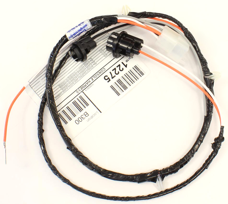

Dick,
I think this should help if I understand your question correctly.
https://www.bing.com/videos/rivervie...=0&FORM=VMSOVR
1. You can get the socket assembly from several vendors, including our host:
https://www.amesperf.com/parts/20965/
2, Disconnect the orange wire from the socket. The bulb will come loose as the wire prong end also acts as the keeper for the bulb tab. To remove the orange wire from the socket, you have to take a mini flat blade screwdriver and through a slot in the housing, GENTLY AND CAREFULLY push the metal hook/bulb connector inward just a little bit so it releases from the housing. The originals had a little tab to hold it in. I assume the repros are the same.
3. Install the socket from the top. Insert in hole and push down until clips engage.
4. Connect orange wire from underneath the console into the socket and replace bulb.
5. Splice new orange wire into existing harness under console. Here's a picture of the console harness so you can see where the two orange wires go from the connector to the box light and rear courtesy light.
https://amesperf-parts.s3.amazonaws.com/M12275.JPG
Hope this helps.
Terry
