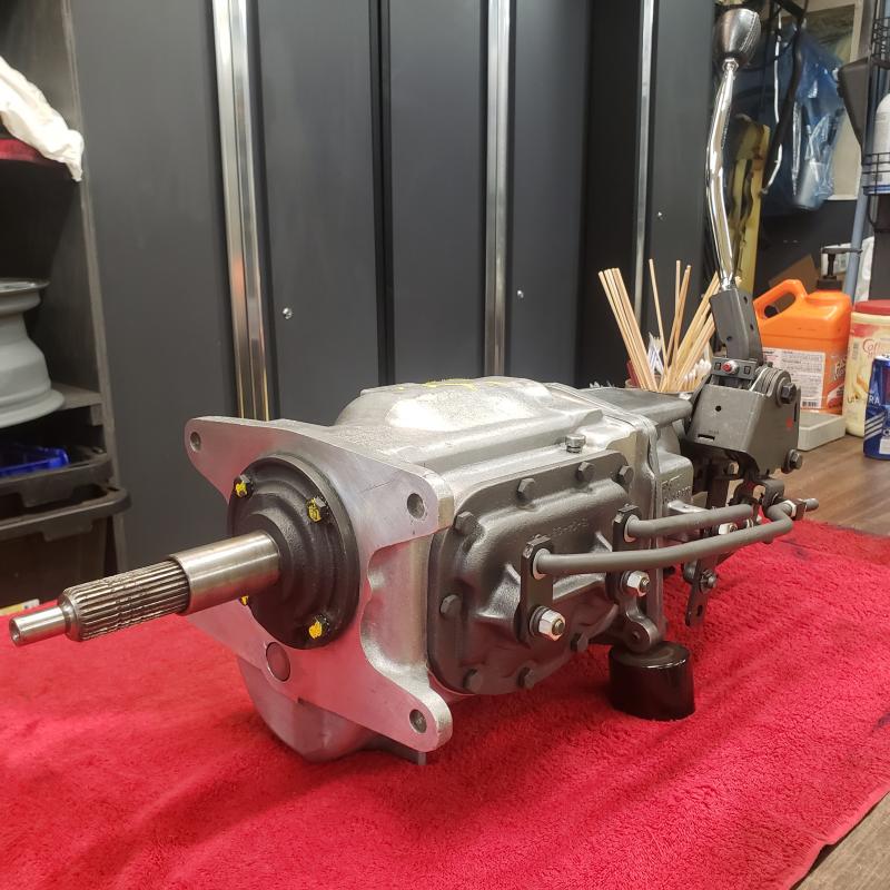

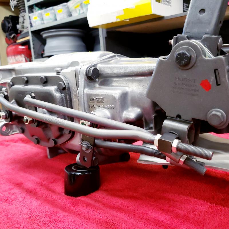

Various completed pieces for my white/white W72 4 speed. Body itself is in paint jail.
ID:	650009   Click image for larger version
ID:	650010   Click image for larger version
ID:	650011   Click image for larger version
ID:	650012   Click image for larger version

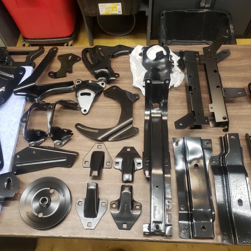

Old 04-08-2025, 08:27 PM
costpenn costpenn is offline
Join Date: Dec 2023
Posts: 61
Default More Part Resto Photos
Some more goodies
ID:	650014   Click image for larger version
ID:	650015   Click image for larger version
ID:	650016   Click image for larger version
ID:	650017   Click image for larger version
Old 04-08-2025, 08:32 PM
Join Date: Dec 2023
Posts: 61
Default More Parts Done
Just a few more
ID:	650019   Click image for larger version
ID:	650020   Click image for larger version
ID:	650021   Click image for larger version
ID:	650022   Click image for larger version
Old 04-09-2025, 10:42 AM
77 TRASHCAN's Avatar
Join Date: Oct 2008
Posts: 6,750
New evap core???
Who did your carb?
Shut it off
Shut it off

Old 04-12-2025, 06:35 PM
Join Date: Dec 2023
Posts: 61
Hi.
Evap core is original. Had it pressure tested at the radiator shop.
Carb was done by Carb Junkys in Georgia. Absolutely spot on finishes

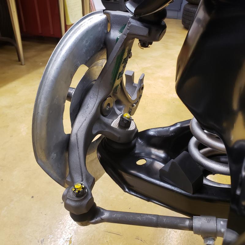

Old 07-28-2025, 12:21 AM
Join Date: Dec 2023
Posts: 61
Subframe progress
ID:	655011   Click image for larger version
ID:	655012   Click image for larger version
Old 07-28-2025, 07:10 AM
provocating provocating is offline
Join Date: Jul 2025
Posts: 29
Originally Posted by costpenn View Post
Subframe progress
What is coating the frame?

Old 08-05-2025, 12:37 AM
Join Date: Dec 2023
Posts: 61
Hello - it is "Railing Black" powder coat. I know it should be that flatter watery looking asbestos black paint, but I plan on driving this one after doing some shows.
