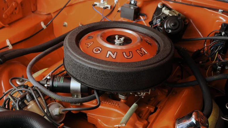

Total nonsense. The "air bubble" (if it exists at all) inside an oil-filled coil is so tiny as to be not worth discussing. He should know better--he's generally a sharp guy.
Mother Mopar put them horizontal;
As did Ford:
How about Volkswagen?
MG?
The idea that oil-filled coils have to be "straight up" is TOTAL BULL****.
