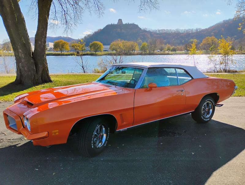

I have the same car, but with the 400/400. I went to a couple of shops that also couldn't balance wheels due to your issue. But, the one that did, convinced me using his spring loaded style should work. It did. I have no vibrations and it runs smooth at 70 mph also.
I do also like the sport mirrors. Click image for larger version

That's pretty. I definitely want to add the sport mirrors after seeing that. I had always intended to but I was worried I'd have to cut up the door and add the reinforcement on the inside for the remote mirror mount, but this summer I took that chrome mirror off to make a new gasket for it and I saw it's already drilled and reinforced for the remote mirror. So that'll definitely happen in the next round.
