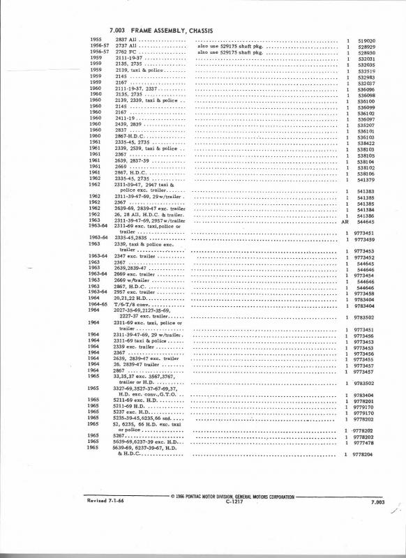

What year frames interchange on a full size wagon? Thanks Geoff

I would guess 63 and 64 definitely, 62 maybe.

Check these pages from parts book. There may even be some interchangeability with 61 and 62 where the only difference is a hole or a different gusset. But I can't swear to it.
