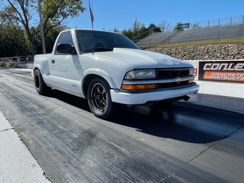

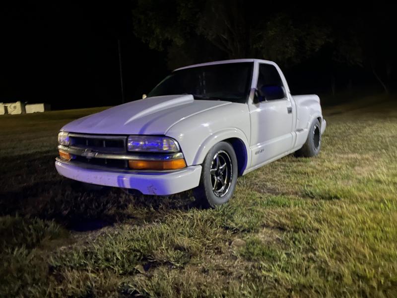

Here are a few pictures
ID:	665241   Click image for larger version
ID:	665242   Click image for larger version
ID:	665243   Click image for larger version
ID:	665244   Click image for larger version
