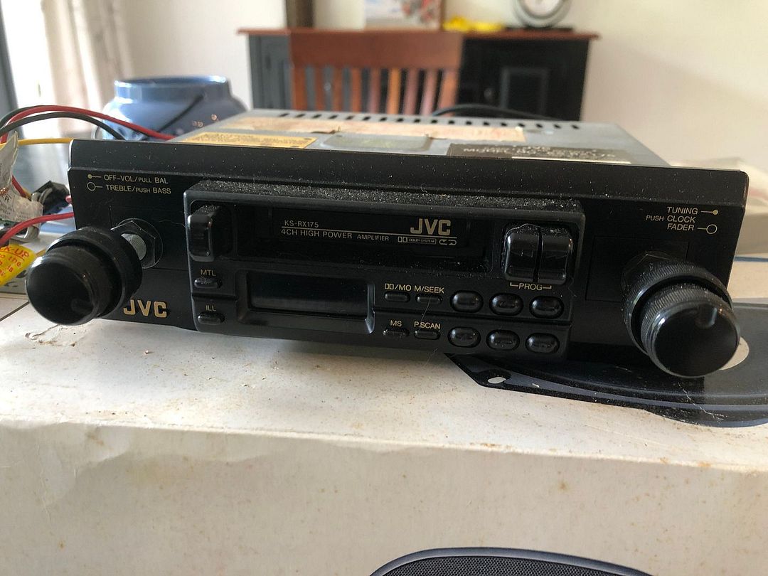

I was back in the US for a visit recently and I came across a JVC stereo on FB marketplace. I picked it up thinking I might install it in the TA if I could do it without cutting or heavily modifying anything;
It came with a set of JVC 6x9's and the knob spacing is adjustable. Plan was to install this and remove my 8 track player and replace it with the stock console pocket.

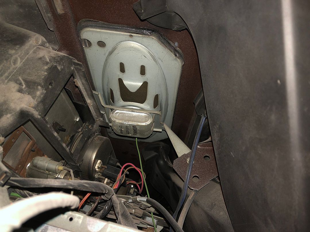

The rear speaker install should be pretty straightforward, but I'm not looking forward to tackling the underdash speaker. I'd love to hear any tips or tricks.

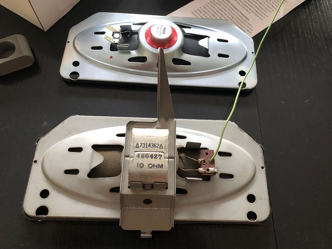

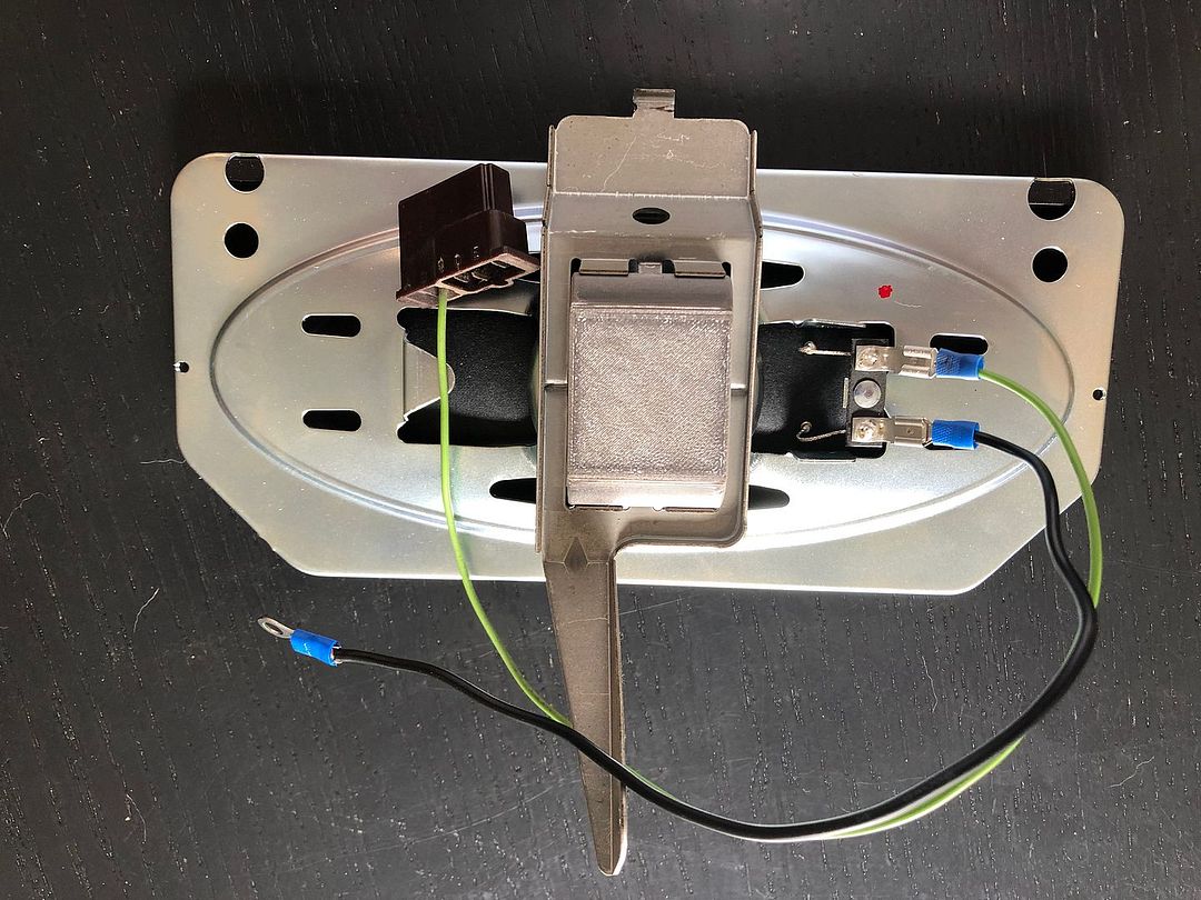

I had little problems pulling my speaker, but mine is a non-A/C, non-console car.
One screw holds the bracket that holds the speaker in place. Unplugging the radio and press the tab on the green wire terminal releases it. Ground is thru the body of the speaker. I made a new green wire and soldered it on the one terminal of the speaker. I attached a Packard series 56 female terminal to the end that inserts into the radio connector. You will have to use all crimps over there. A black wire with crimps on both ends (should be in kit) plugs into the speaker terminal and I connected the other end to the attaching screw.
I'd love to see the ink stamping after you've pulled them.

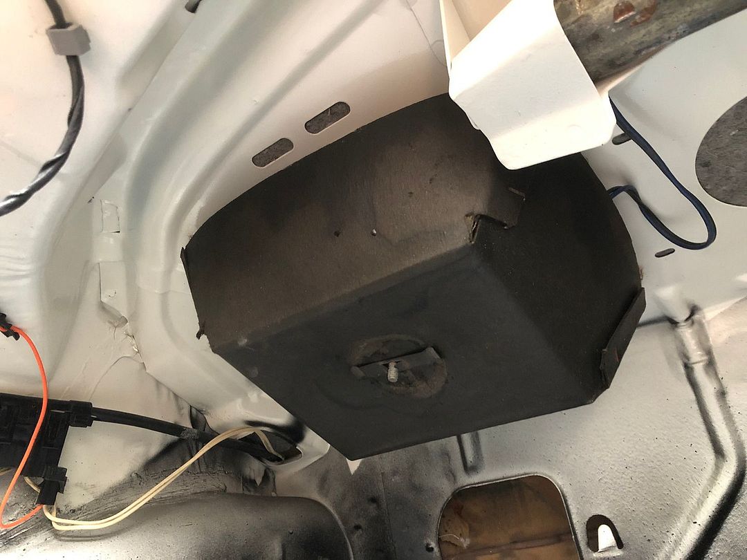

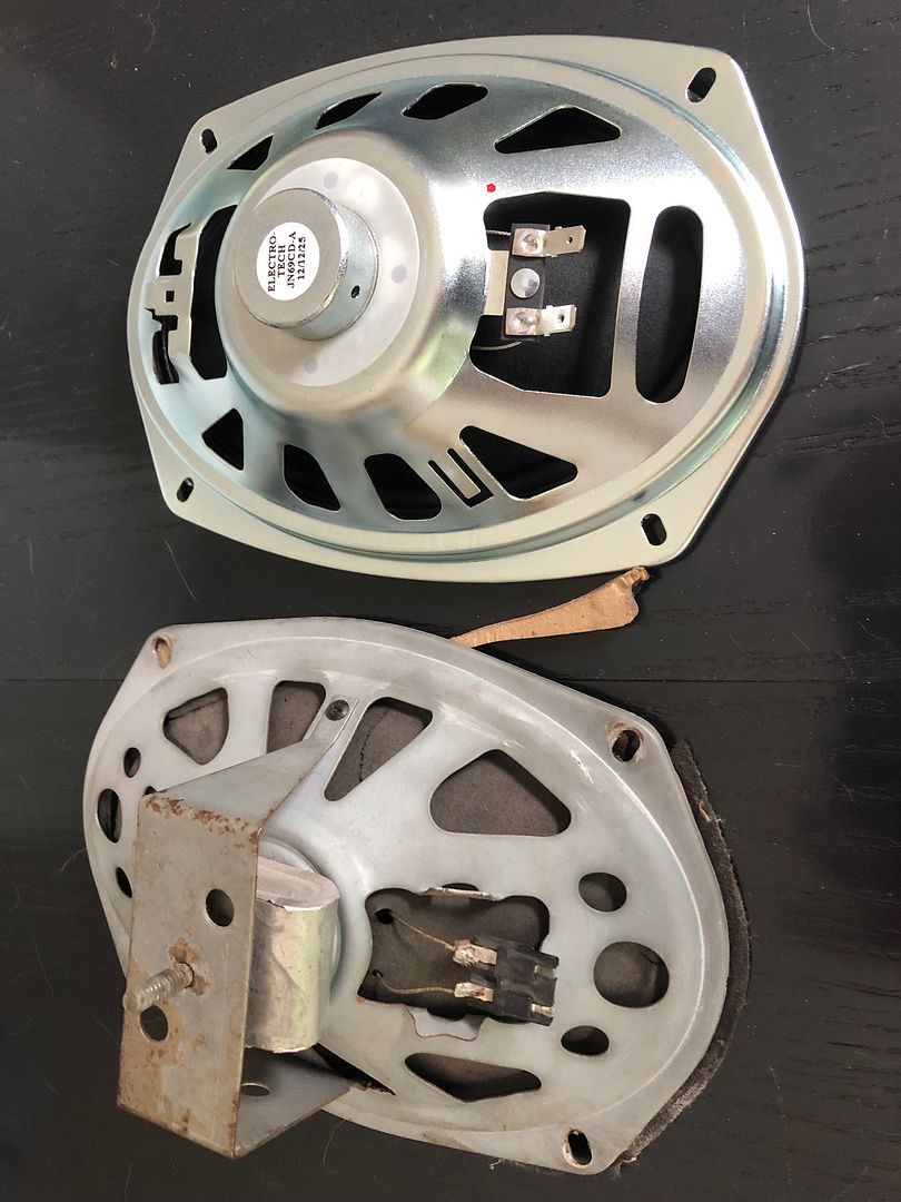

I've started with the rear (easiest first). I'm going to carefully drill a couple of holes in the new speaker so that I can mount the bracket for the jute filled enclosure that mounts to the speaker after it is fitted.
Old and new rear speakers:
Peter
1974 Trans Am, 400 4-speed, 3.42 rear.

Great, now I'll have to figure out how to affix the rear speaker connection...

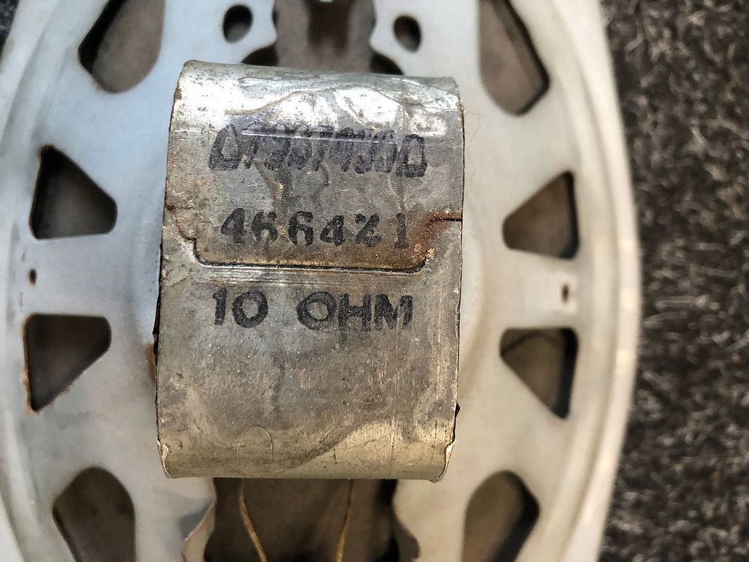

I'm going to harvest the plug off the original rear speaker and mount it to the new speaker so that I can plug it in using the original harness.
Numbers from the rear speaker:
Peter

May 20-26th, 1974 speaker. When was the car shipped?
So long, farewell.

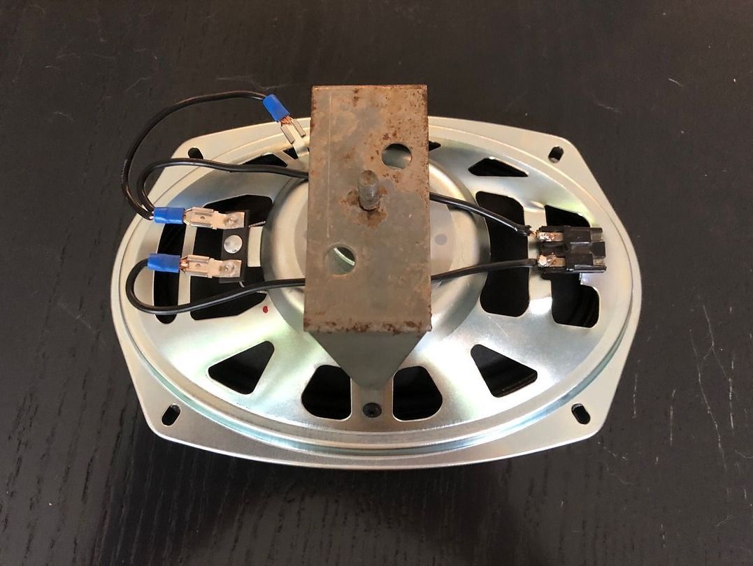

You could unsolder the leads and drill out the rivet and use the original terminal assembly on the new speaker.
Old 04-09-2026, 05:37 PM
pontiacstogo's Avatar
pontiacstogo pontiacstogo is offline
Join Date: May 2001
Location: Waihi, New Zealand
Posts: 562
I had planned to do just that - but the bracket on that side is wide at the top and I wasn't sure how I'd keep the wires that go to the speaker cone away from the speaker frame.
In the end I removed the plug from the original speaker, mounted it on the bracket on the opposite side and then made up some short leads to attach it to the reproduction speakers terminals:
All installed and working:
The RH knob on the 8 track player is a fader between the front and rear speakers. My radio is AM only.
Peter

Now on to the front speaker.
Before removal:
Old and new:
I ended up taking the glovebox and center console out just to give myself plenty of room to work.
